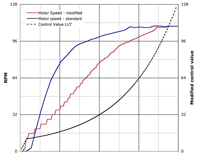

I’m also currently re-evaluating some of the motor control code. The slew rate control is part of a motor control library that team 8888 uses that also implements a non linear mapping from requested control value to output control values. It has occurred to me that this LUT should be used after slew rate rather then before as is currently implemented. The LUT is a power function that was created before the work this summer looking at the non-linear characteristic of the motor controllers, the current LUT we use is as follows.
[ATTACH]6829[/ATTACH]
The blue line shows how the (unloaded) motor speed varies with control value. The black line is the non-linear mapping applied to the control value and the red line shows the resultant motor speeds with the revised input. It’s still not linear but a better approximation. One day I will also measure a loaded motor but it’s low on my list of to do’s.
