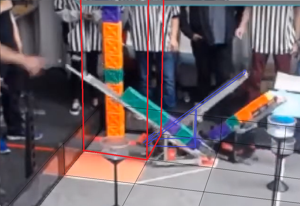

During Finals Match 1, at approximately 1:47, the blue alliance crossed into the inner protected zone volume. As laid out in Q&A 449, because the blue alliance was blocking the protected zone and was then pushed into it as a result of offensive maneuvers by the red alliance, this should be a disqualification for the blue alliance.
185A violation 2
During the same match, the blue alliance crossed into the inner protected zone volume at 1:19, which is also an automatic disqualification.
185A violation 1

For the inner protected zone violations, it doesn’t look like that was enforced correctly if they weren’t calling them (you did a good job pointing those out in the pics, btw). That can be very hard to see in fast game play, but with multiple refs and it being a DQ offense you’d hope it would get called more.

About the zone, iirc, the rules state that it is if you contact the ipz, not if you break the plane. Auto line is also tile contact. Full containment in the opz is plane based, though, from my interpretation. I think vex needs to clarify what is a violation by plane break and what is a violation by tile contact.
Because the IPZ is a 3D volume, not just an area on the foam tiles, “contacting the inner protected zone” and “breaking the plane of the inner protected zone” are equivalent. See Q&A398.
