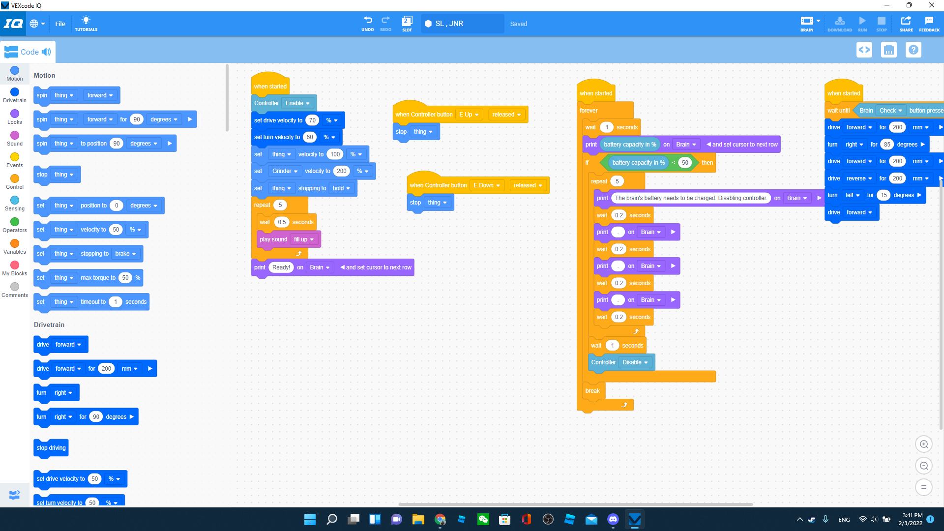

So I made a code that is for my robot. However, when I press a button, the motor spins, yet when I release the button, the motor releases like it has no strength. A friend of mine named Brandon somehow fixed this, but because he made it on his computer, then I can’t get it. I can’t email him either; he’s always busy. So how do I make the motor lock? (with program instructions, please!)

simple
if(Controller1.ButtonX.Pressing() == false){
Motor.stop(hold);
You can also do motor.setBrake(hold); once, so then every time you do motor.stop();it will hold the position.
https://api.vexcode.cloud/v5/class/classvex_1_1motor?member=classvex_1_1motor_1ae73c540b60bc8196d657b125cdfb2abb
or more descriptive help page for V5 API here:
https://www.robotmesh.com/studio/content/docs/vexv5-python/html/classvex_1_1_brake_type.html
Here’s my code
Using Blocks, explore the ‘Braking’ block and what the 3 different options do.
I fixed it. Thank you for your cooperation!
