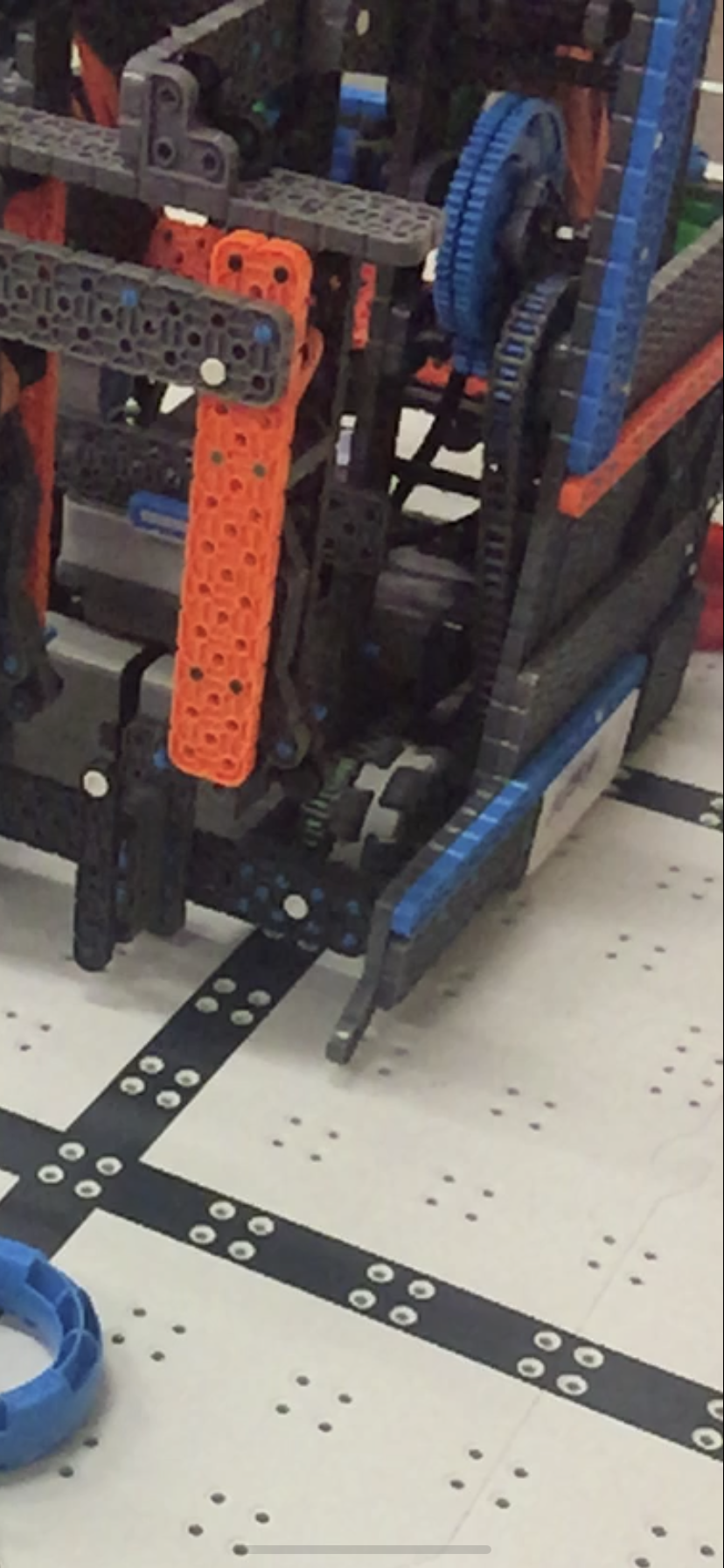

Here are some pics from my robot back in Ringmaster this is an RD4B but the method of powering will be similar.
I had no issues with this design throughout the season and with proper banding and PID on the Lift, we were able to hold 27 Rings on this bot. US Open Finalists and 2018 Tech Division 3rd Place and Design Award!!
