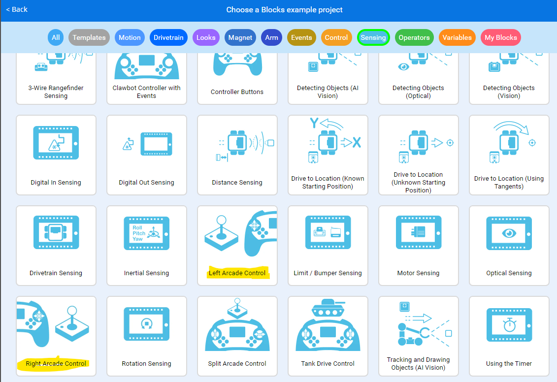

How would you code this with the joysticks to make it turn during Driver Control?
There are a number of Examples you can reference in VexCode.
Below is the right arcade drive.
