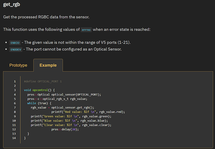

How do you program an optical sensor(c++)
For our color roller this year we are going to be using a flex wheel that spins with a motor and we want to have an optical sensor to determine what color the roller is on. When the desired color is showing on the color wheel we want our motor to stop spinning. There is one slight issue though, I don’t know how to code this. My knowledge of coding ends after driver control and autonomous. I use PROS for vex and I code in c++. I would really appreciate if you got back to me soon. Thank you.

https://pros.cs.purdue.edu/v5/api/cpp/optical.html
^ optical sensor api

Also I know what an optical sensor does but I’m not sure of how to code the functions in pros.
