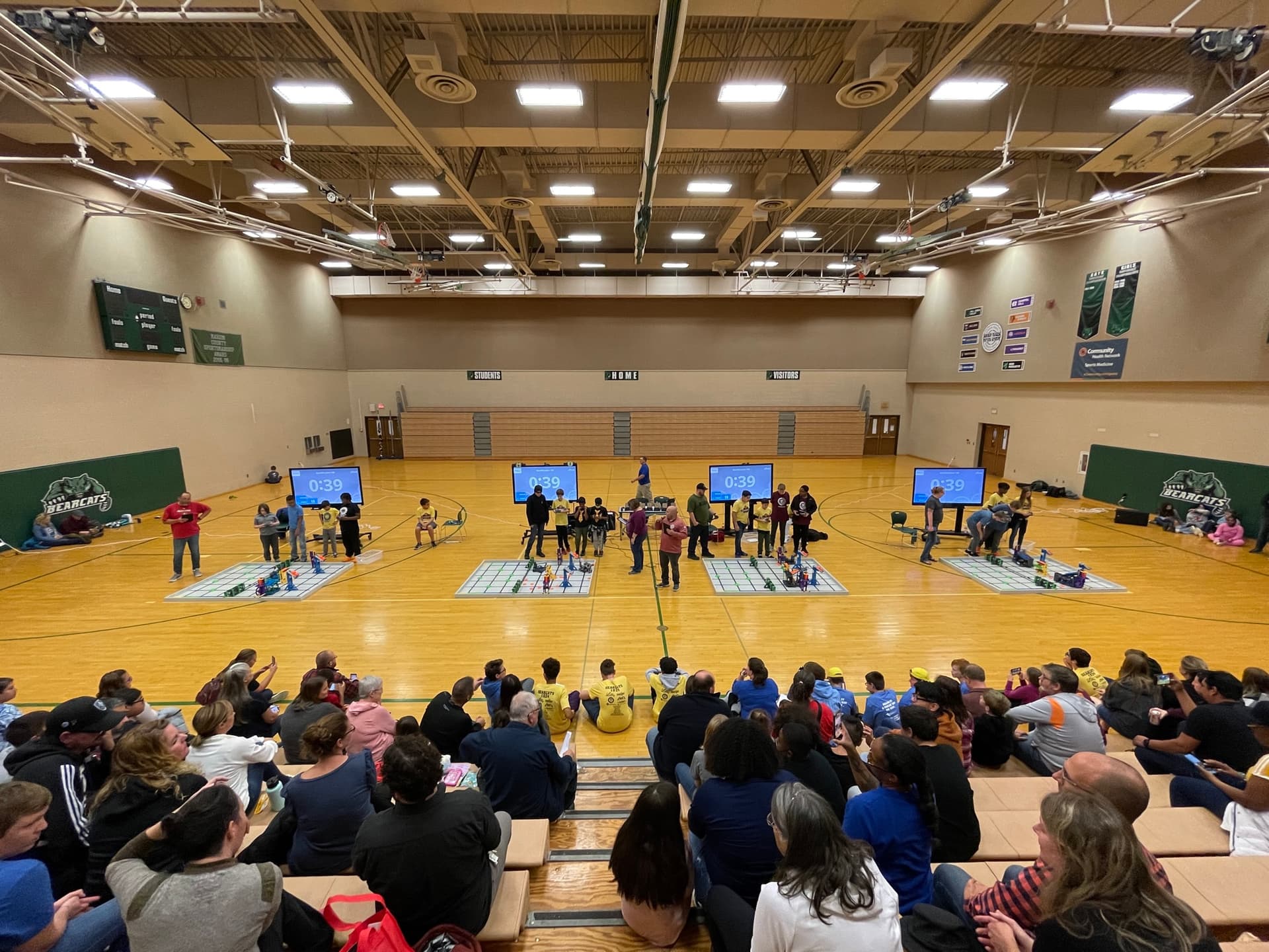

This is our setup from last match for reference

Have matches 1-4 set up on the fields, queue up match 1 and run it. After that, set up matches 5-8, queue match 5 and run it. Teams will look at the field monitor to see field assignments but then look at the audience display monitor(s) for the timer. If you don’t care about having the upcoming matches shown at each field in between, you can just configure the monitor at each field to be an audience display. I think that’s what was done in the picture above. The audience display will only show the teams from match 1, 5, etc. so you’d have to just overlook that.
