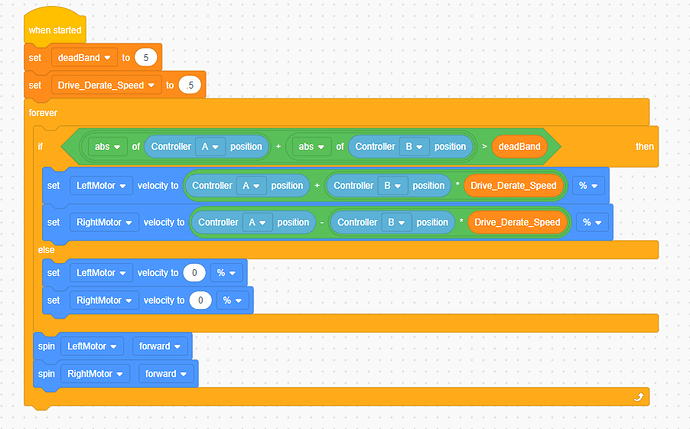

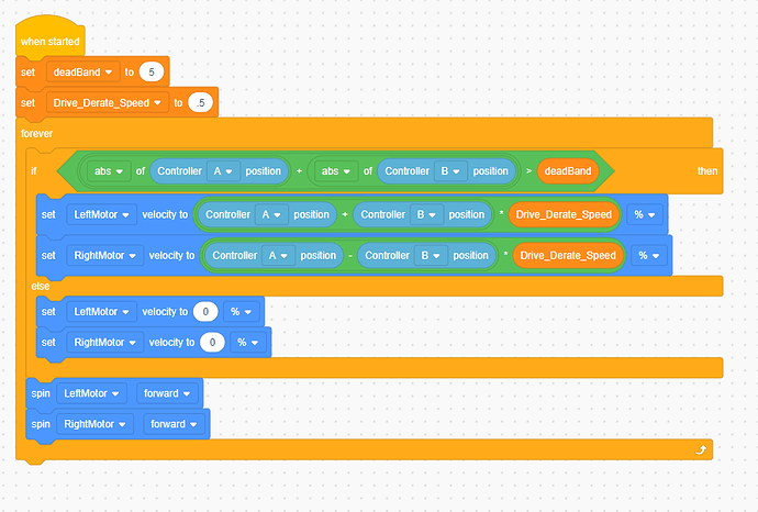

See the two example codes with using left arcade stick with a derate multiplier to slow it down. Order of Operations would seem to make the first code slow down the turn input only (+/- B stick), while the second code derates both turning and forward (A & B Sticks).
In reality both pieces of code act exactly the same.
If one were to want a slow turn and normal forward/reverse, how would they go about that?TEST turn TEST both

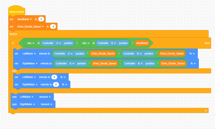

That did it! Notice the subtle difference on how the operator bubbles fit together from this third code from the first one. Thanks for all the help! :joy:
correct turn derate
