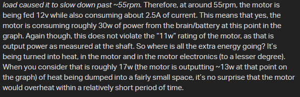

I honestly wouldn’t worry about it too much. for a typical high school robot you really won’t notice much difference unless you went down the path of using sixteen 5.5W motors and, with the current trend of using six 11W motors for the drive, I don’t see anyone doing that. You can also see peak power in the graph occurs somewhere around 65% of max rpm, and current is actually a little lower than 2.5A at that point and power higher than 11W.

It’s important to keep an eye on the big picture here. Heat is a critical part of that.
Additionally… the total current limit of 20A. That’s a fairly high number for the small-ish wiring & connectors in the system. Probably a safe limit, when looking at heat generation and component stress, to keep things at.
