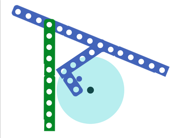

Here is a crude drawing but this is my guess. A pin / standoff rotates between two gears and there is a L hook that grabs on to it until it rotates around the axle and falls away from the hook causing it to release.
It would take some testing to identify where the pin is placed and the size and placement of the hook. You would also need to prevent the hook from hitting the axle. You could place pins at 180 degrees and it would fire every 1/2 turn.

I don’t understand what makes sure the L hook engages with the pin. Is the L hook only secured in one place to the catapult arm or is it pinned to the gear as well?

The hook is only connected to the catapult arm and its swing is limited. Now imagine two gears with a standoff separating them - this will be the cam. The cam comes around and grabs the hook to pull it down. As the cam rotates out of the reach of the hook it releases.

I have been having troubles on keeping the swing limited, when the hook touches the gear it slips and won’t go down. Whats your thoughts on this?
One option would be to make it fixed. Another would be to add pieces adjacent to limit the movement. In the example pic below the left grey piece would allow some movement and the right piece would stop it at 90 degrees. (Assuming they are all in the same plane against the catapult arm)
After blocking some swing movement the motor can’t take the catapult down.
