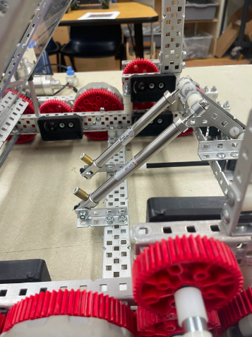

I apologize if this has been asked before, but I did not see a ton of answers to this question. How does your team attach their pneumatic cylinders?
I am currently working on a CAD drawing and noticed that the pneumatic cylinder mounts are actually old. So, pretty confusing. I’m struggling to see how you could attach them. Pictures are greatly appreciated. Thank you.

We attach our cylinders using the gap that you can slide the screw through and ziptie the other side. Heres a picture:
Screen Shot 2024-08-11 at 6.38.10 PM
Definitely with zip-tie. However we usually have a c channel below to support the tank and attach any additional protection.

What pieces do you use to attach the end of the cylinder to a c-channel, angle, etc.? I looked in our kit and don’t see anything that would allow us to do that.
We used the 1x1 aluminum angle pieces. Here is a link to purchase: https://www.vexrobotics.com/aluminum-kits.html

We use a long screw for both pneumatic cylinders on the sides of a c-channel. You can use Nylock nuts with a locking screw, as long as you don’t screw it in too tight.
