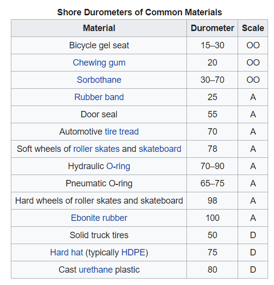

I would say the 30A light grey ones might be the best. Here’s a chart of common items for reference:
You can research more about Shore Durometer if you want to know more about what the <#>A numbers mean.
