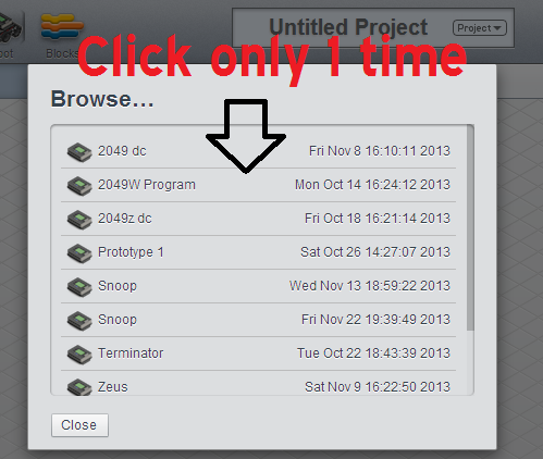

Logged in via Google account and saved a project. It appears in the Browse box but when you open it, there is no components and no brain. The parts flash onto the screen for a fraction of a second and then disappear. The brain tab stays at the top but the brain itself does not show. All the other components and the blocks part of the program disappears. You can add new parts but tabs do not appear for them. You can’t go to Project - New either as this does not work. You have to go back to the modkit/vex and re-launch.

I had the same problem with the motors and brain disappearing when opening a project, The solution I have found its when you click projects->Browse click only one time on the project name and give it time to load. If you double click items will disappear. My students use both Google and yahoo and this was the fix for both.
Amazing what a little bit of impatience does! Cheers for that Bart, does indeed work as you suggest. Have you reported this bug to Modkit already?
