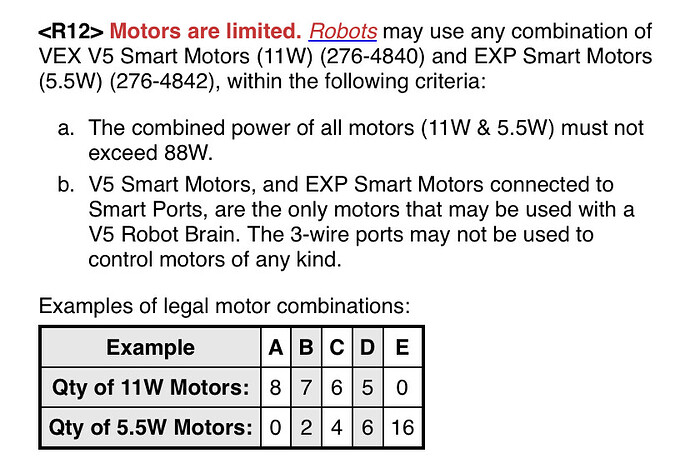

Hi! I kindly recommend reading the VRC Over Under game manual. I have linked the game manual here: VRC Over Under Game Manual - VEX Robotics.
I have also attached a picture of the rule where you can find the answer here:
Another easy way to think about the motor limits is that an 11W V5 motor equals “one” motor, and a 5.5W EXP motor equals “one half” of a motor. You can have eight V5 motors, or trade V5 motors for EXP motors one-to-two (for every V5 motor you give up, you can add two EXP motors). Hopefully this helps…?
