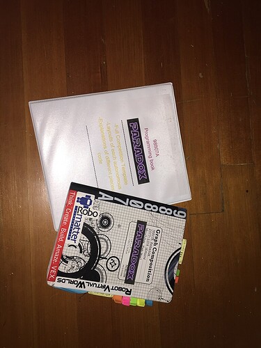

We currently have 5 130 page engineering notebooks and 2 programming notebooks where we have tracked and explained our code.
Having a very solid notebook has allowed us to earn 4 excellence awards and 2 design awards at 6 total events this season including our state tournament.
