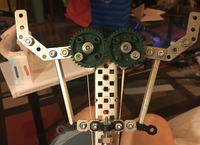

I think I’ll switch over to four wheels, but what do you guys think about my claw? How big does it really have to be?
Do you have cones? Based on the height it rests at, and the shape of the cones, it should be readily apparent (and simply a matter of tweaking).
