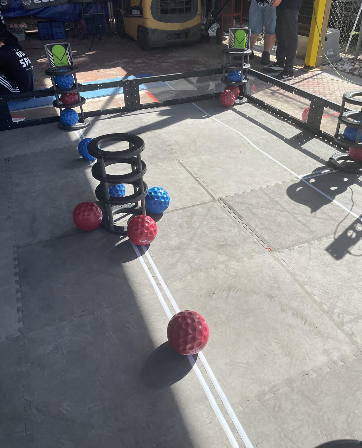

As a matter of fact, in one of our qualification matches, we had to stop driving our robot because the drivetrain was too overheated. Our sister team’s intake motor (they had a 2 motor intake with no spare motors/cartridges available) overheated to the point of un-usability (thus they had to resort to defense in their later matches). Our mentor even had to leave the venue for a short while to get us more cans of compressed air for our robot (thank goodness for that). The heat was so bad a heat pocket/bubble formed on the field being used for SF #2:
(this photo was taken directly after the aforementioned semifinal match. Notice the curvature of the red alliance home row tape line)
For the finals, the EP graciously decided to give the alliances a couple minute “robot cool down” break in-between each match.
