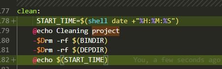

I want to count the compile time. But it seems that I have a problem with the location of the code that gets the time
Please, try the following method that worked for me:
DEFAULT_BIN = sleep3
all:   print_start   $(DEFAULT_BIN)   print_end
print_start:
	@echo $(shell date +"%Y%m%d%H%M%S")
sleep3:
	sleep 3
print_end:
Where sleep3 is a stand-in target for the default $(DEFAULT_BIN) target that compiles your code.
is this possible to do with VexCode?
There’s another problem
I set a variable ·START_TIME·
I cannot assign the acquired date result to START_TIME
@3038922, please, try this version of the makefile method:
print_start:
	$(eval START_TIME:=$(shell date +"%Y%m%d%H%M%S"))
sleep3:
	sleep 3
print_end:
	$(eval END_TIME:=$(shell date +"%Y%m%d%H%M%S"))
	@echo START=${START_TIME}
	@echo END=${END_TIME}
@kickthepokehi, I have Linux make and do not know if same method works on Windows make of VEXcode.
