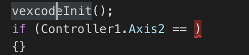

How to add code for the controller manually?
When I am trying to code the controller manually, I don’t know which identifier to put for Controller1.Axis2 == identifer… Does anyone know what to put?
Screenshot 2023-03-18 at 5.57.35 PM
What are you trying to do with axis2? Like are you trying to drive the robot?
I am trying to manually code the robot without using the drivetrain setting made by vex
I am trying the drive the robot

Firstly, you will need to put it inside of driver control. Second, you need to use Controller1.Axis2.value(). This will return a value between -100 to 100. Typically, vex teams will set the speed of the drivebase to this number in percent using each drive stick to control a seperate side of the robot. This is referred to as a tank drive.
Which is not a great idea. The code generated by the block to C or Python generator, although being functional, is not particularly good code.
controller::axis::value() will return an integer from [-127, 127] (don’t use this)
controller::axis::position() will return an integer from [-100, 100]
Here’s basic tank drive using two motor groups called LeftMotors and RightMotors (and a controller called Controller):
int usercontrol() {
    while (true) {
        int32_t left_speed = Controller.Axis3.position();
        int32_t right_speed = Controller.Axis2.position();
        LeftMotors.spin(vex::forward, left_speed, vex::percent);
        RightMotors.spin(vex::forward, right_speed, vex::percent);
        vex::wait(10, vex::msec);
You can swap out the values left_speed and right_speed to get other input methods.
For example, here’s dual-stick arcade:
int32_t left_speed = Controller.Axis3.position() + Controller.Axis1.position();
int32_t right_speed = Controller.Axis3.position() -  Controller.Axis1.position();
… or single stick arcade using just the right joystick:
int32_t left_speed = Controller.Axis2.position() + Controller.Axis1.position();
int32_t right_speed = Controller.Axis2.position() -  Controller.Axis1.position();
The actual actual vex::drivetrain class also implements a deadband to account for slight cases of joystick drift, although you probably don’t need this:
#include <cmath>
int usercontrol() {
    constexpr int32_t DEADBAND = 5;
    while (true) {
        if (std::abs(left_speed) < DEADBAND) left_speed = 0;
        if (std::abs(right_speed) < DEADBAND) right_speed = 0;
