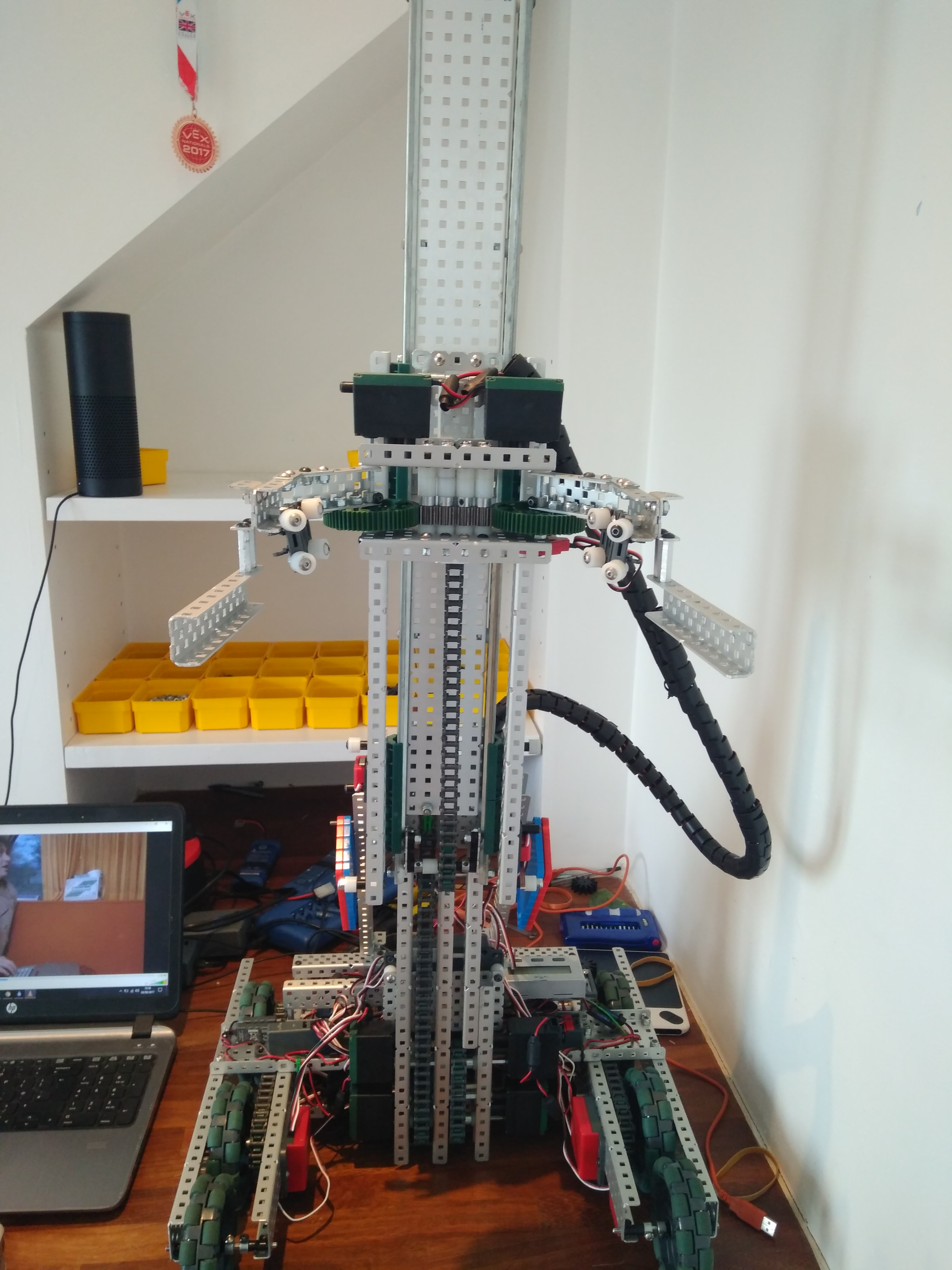

Your in luck we built that exact same lift. If you want more power you can try doubling up the motors. That is what we did. I attached a picture of our robot below. Speaking of which, @jpearman might be able to give you a hand if he feels up to it, he is the original creator the lift that we are shamelessly stealing.
This is the original thread that shows more details than the animation.
The key to success is attention to detail and good build quality, it takes some time to adjust everything to get smooth and friction free operation.
