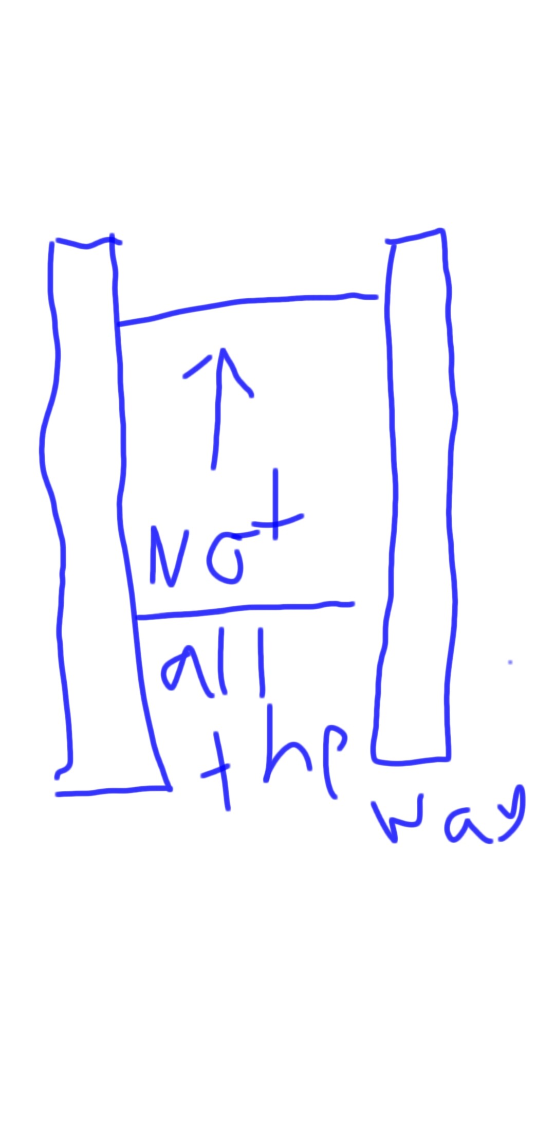

can you send pictures? they way ur describing this comes off as
you are using only standoffs to brace ur outer channels (a nono) and you don’t have supports going all the way across. Also make sure you don’t have any metal on metal contact, and the spacing with the wheels isn’t too tight. also make sure ur motors are centered on the holes. There is a tutorial on how to square, and it’s in the blzi tutorial 1 ChassisPart1 - YouTube .
