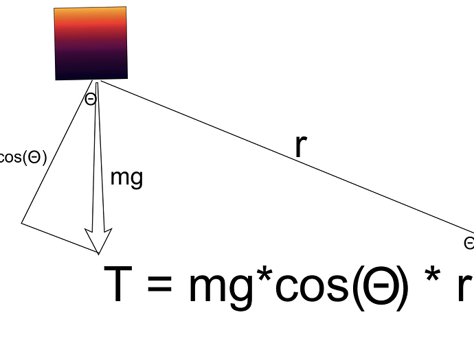

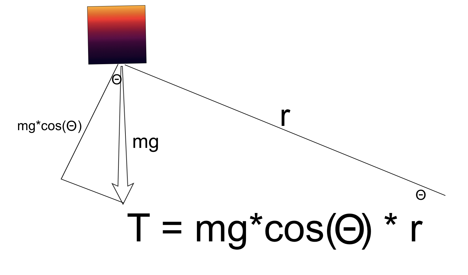

Torque is equal to the component of the force pointing perpendicular to the radius times the radius.
In your setup, the force would be the force of gravity on the object you are lifting (mg) times the cosine of the angle of elevation.
Image attached.
Oh that is torque when an object applies the rotational force onto the lever, but how would you calculate torque of a lever applying a force onto an object?
If you are trying to see if the weight of an object will make a motor stall, there is your equation. I’m not 100% sure what percentage of stall torque a motor is applying all the time (I guess 100% of stall torque if it is acceleration to its rated rpm?), but if torque = force * distance from the fulcrum, then you just solved for force. Technically a lever would apply force, not torque, to an object to achieve translational movement at a specific moment in time. So, the force the motor could apply equals torque/(distance from the fulcrum), where you have torque and distance from the fulcrum.
