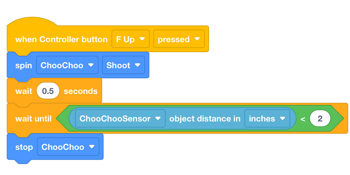

To code it, you need a distance sensor and code like this:
Position the senor so that it detects when the arm is at its lowest point
Yes that makes sense, thank you!
