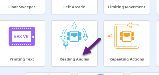

When you download VEXCode v5 Text, you can go to ‘File’ > ‘Open Examples’. In the list of examples you’ll see the ‘Reading Angles’ example which will ‘Print the potentiometer values to the V5 Brain’s Screen’.
If you choose to use VEXCode v5 Blocks, it has a similar example called “Reading Angles”:
