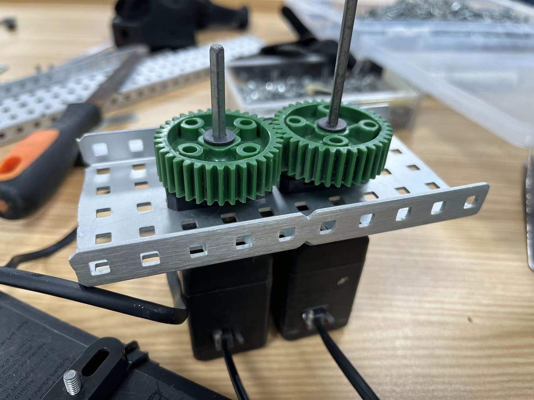

I am testing the dual-motor parallel connection in V5,which are coupled using gears. After a period of rotation, the two motors will compete with each other, consuming more and more power.
What is the situation? How to correctly parallel the motors?

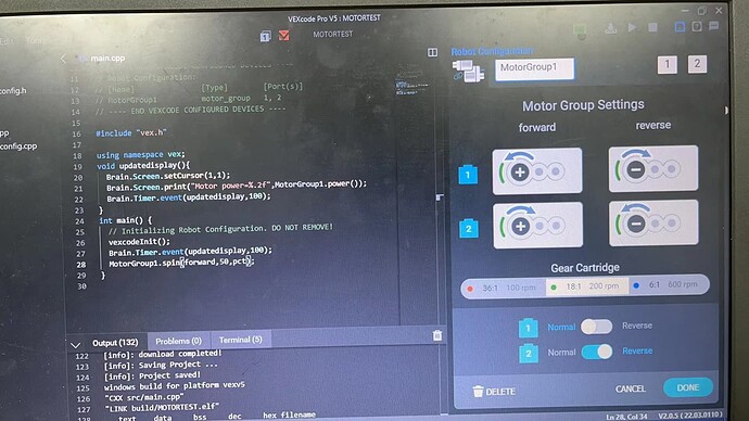

I use motor Group to program the 2 motors and one of them is reversed.
I’m wondering if it’s possible to set voltage of the motor group instead of a speed, which means perform an open-loop control.
The test mechanic is shown in the photo
That’s the code and the motor group configuration
Your description suggests to me that you might be accidentally using motors with different ratio gearing cartridges installed. You’ll see a red, green or blue colour in the arc-shaped window next to the socket for the axle on each motor. For example, the motor on the product page has a green cartridge installed. V5 Smart Motor & Gear Cartridges - VEX Robotics Click through the thumbnails underneath to see the details of the three different cartridge colours and speeds. If your code doesn’t correctly account for the cartridge ratio of each motor - as would be the case if you though they were the same, but they’re not - then they will fight to go at their own speed as you describe. There’s discussion to be had around what kind of stop critierion you set in each motor if you’re getting a problem despite getting the cartridges right, but the healthiest option depends on what the duty and rest cycles look like in the application.
To spin a motorgroup with voltage use motor.spin(fwd, voltage amount, voltage units). An example is motor.spin(fwd,12,volt); this will spin the motor at maximum voltage.

I’m sure the cartridges gear ratio are same and the two motors rotate at almost the same speed when drived independently.
That’s it. The motorgroup works well now.
