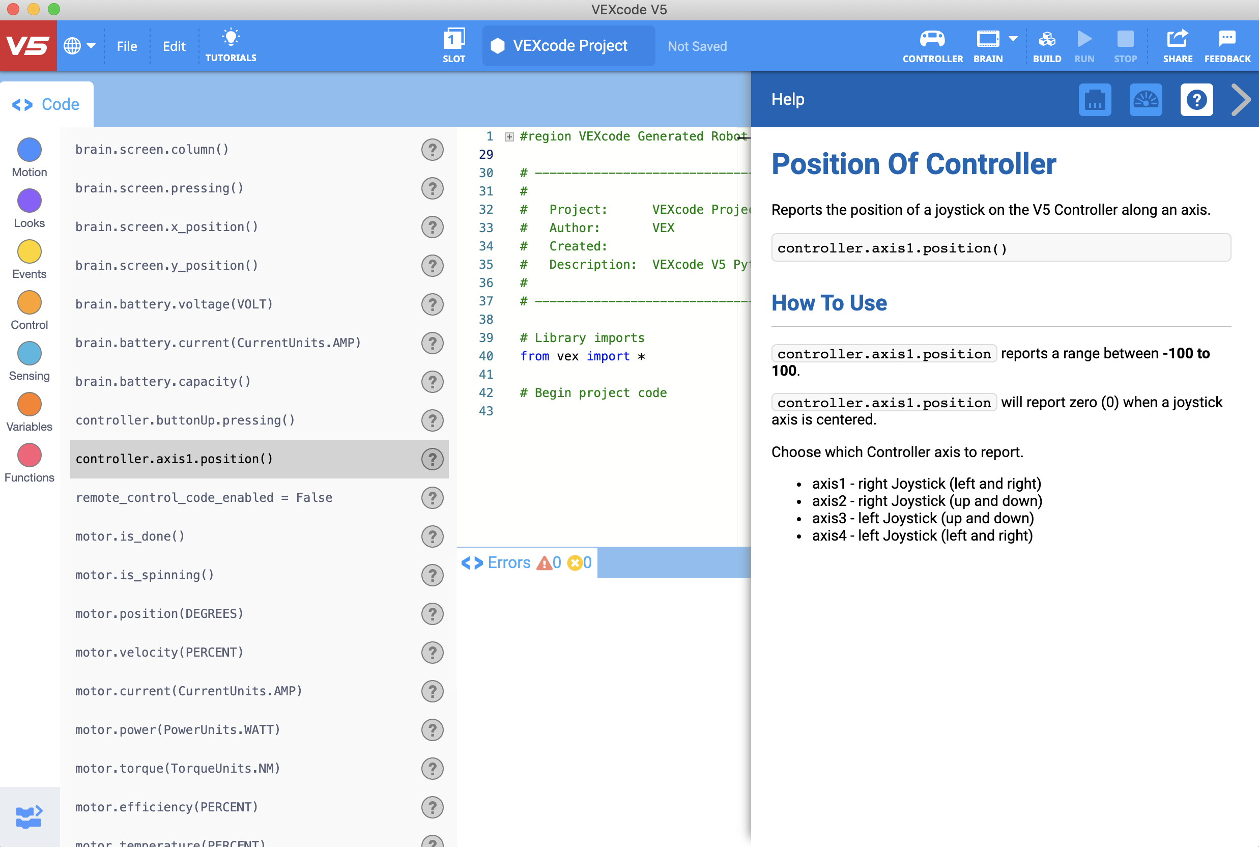

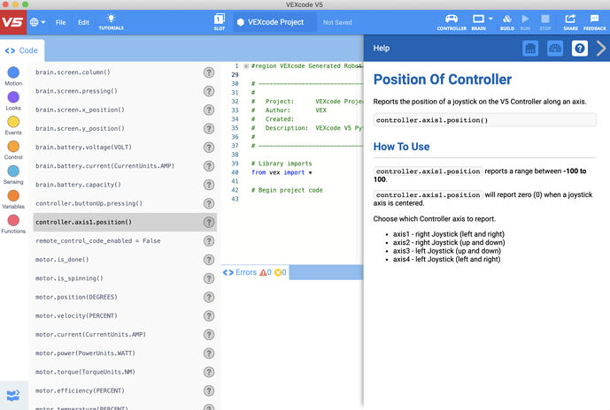

So there is the code for joystic axis but how would i make that into a number?
You are on the right path. Keep going thru the documentation or whatever method led you to find the axis and you’ll find your answer.
I lloked through the documentation you linked but cant find it any hints to where its at?
Not sure why you are having so much trouble with this.
Unfortunately the documentation that was linked is for C++, however, assuming you are using VEXcode to program, create a controller device using the graphical configuration and then help will give you everything you need.
