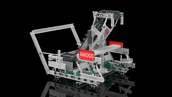

Our team have noticed that the AMOGO bot from H-W used polycarbonate sheets for their intake and wanted to try that out too!. How do you cut and screw in polycarbonate sheets?

The polycarbonate on AMOGO was cut with a bandsaw and drilled with a drill press. For simple parts like in AMOGO where it’s a rectangle with some holes, these tools are a luxury and not a necessity.
Often we will use tin snips, a #19 drill bit (higher quality) or 11/64 drill bit (lower quality) with a hand drill. For tin snips, the more standard kind leaves a marked edge on the polycarbonate. The ones I linked will not leave marks on the plastic.
