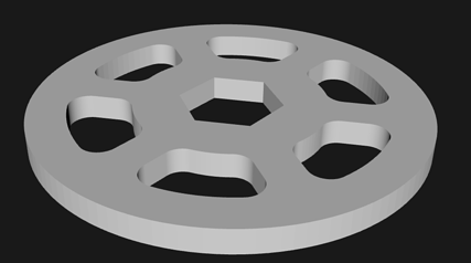

I tried many ways to cut the flex wheel on fusion including using extrude on the flex wheel itself and i still cant seem to cut it. Can someone tell me how to cut it and what to use?
If I’m right when using a vex part it looks the dimensions and editablity outside of the already premade customization of the part. So unlink it from document or something like that and then you should be able to edit it. If not create a sketch on the flex wheel and only extrude the parts you want. Hope this helps

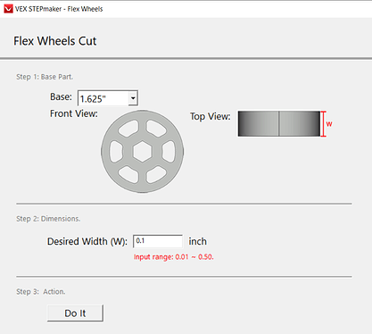

I recommend you use VEX STEPmaker to solve your problem.
You can directly input the width of the flex wheel and generate a STEP file with one click.
