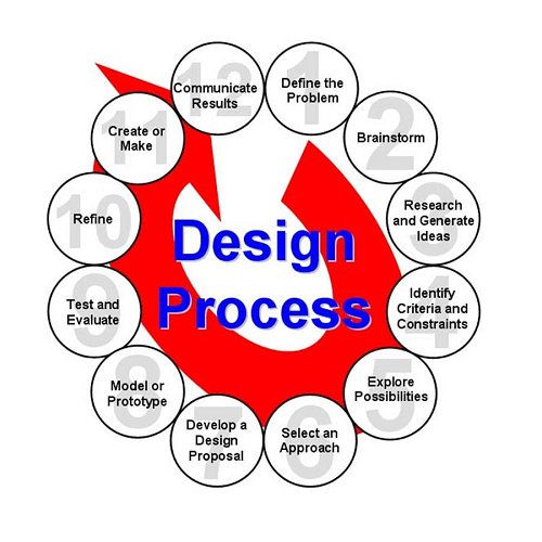

Using the design process is the best way to go about designing a new robot. (Plus the judges look specifically for the design process such as the one I posted earlier in this thread). First you need to:
Define the problem: This means figuring out what obstacles you will have to overcome and what your robot is going to have to do specifically.
Brainstorm: Then you come up with all of your ideas with your team for each subsystem of the robot.
Research and Generate Ideas: Here you will search on the internet for ideas as most people have already started and you just look for other ideas that people have already come up with.
Identify Criteria and Constraints: This is where you will look very carefully over the rules and figure out what your robot can and cannot due during the match and make sure you know these specific rules because they will be important in making your robot.
Explore possibilities: This is where you will look through your materials and see what can you possibly make using the vex materials. You must determine what is realistic?
Select an approach: Here you will gather your best ideas and then decide using a decision matrix which is your best idea for each subsystem of the robot.
Developing a design proposal: This isn’t very necessary.
Model or prototype/Test and evaluate: This is where teams have designed flywheels and launchers to see what works. Just mess around with things, do some tests and see what does an doesn’t work.
Refine: This is obviously modifications done to the robot.
And so on…
