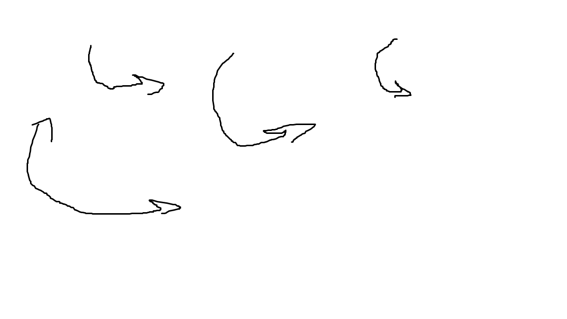

By arc turning I mean that you make this movements :
Could the seperate PIDs create that ratio with the same kP and kD values? Since the current code calculates how far the outer wheel will need to travel and the inner wheel travels the “radius” used to calculate the length of the other arc. If not how can that ratio be implemented in to the current code?
