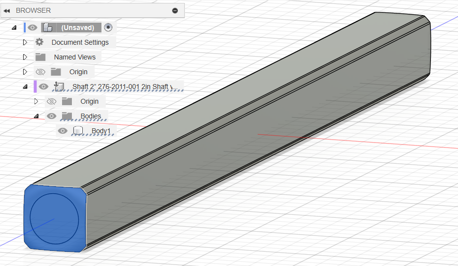

You can select and move the end faces of a shaft.

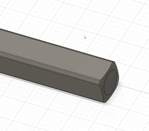

Recording-2024-07-06-111719
Be more specific about what you want to do to which channel and I’ll show you how to do that.
You are using move copy…That doesn’t extend the shaft…It just moves it (You seem to know what your talking about so maybe you just clicked the wrong tool).

Ah, no, I got it right, and it’s very good that you lean into learning something new. Just those selected faces move, and the sides of the shaft are extended or retracted to match up. If you could see the other end, you would see that it doesn’t move. Try it :slight_smile: I should have thought to shorten into the window first to make this more obvious.

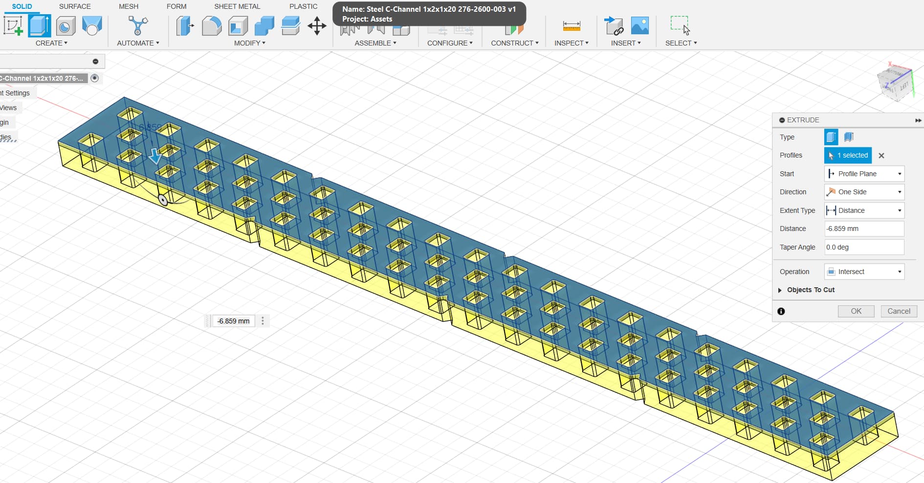

OK, to your C channel. There are lots of ways of doing it. The quickest one would be to select the internal face - the one you can see lying horizontally in your image - and extrude that downward and use the intersect operation.
That will create a new body in the active component and delete the original channel body from its component. To keep the original body, create a new body from the extrusion instead of immediately intersecting, then perform a separate intersection and select “keep tools” so it isn’t deleted.

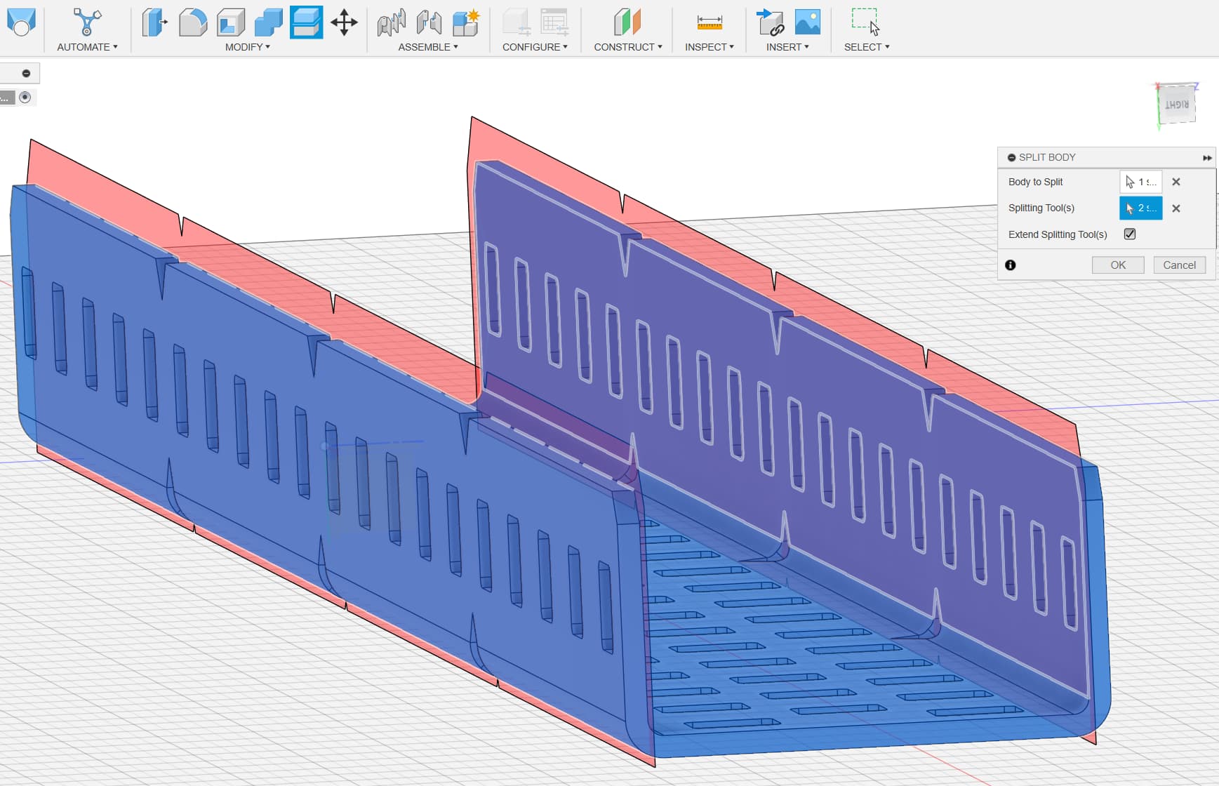

Another way would be to use the split body command and use the vertical inner faces of the sides to perform cuts.
That will cut the original channel body into three parts; centre, side, side.

Which library are you using? Clicking on all sides of the axle doesn’t select that side of the axle (suggesting there are no faces on the axle)
As for the C channel, following the steps you gave me I get the “No target body found to intersect!”
I’m thinking we are using different libraries.
I’m using the original CAD models from the vex website in this instance, but that’s not relevant to solving your difficulty. You can definitely achieve what you need with the library you are using.
“No target body found to intersect” is happening because the thing you’re trying to edit is still linked back to the source.
https://www.autodesk.com/support/technical/article/caas/sfdcarticles/sfdcarticles/No-target-body-found-to-cut-or-intersect-when-extruding-in-Fusion-360.html
Right-click the component and select “break link” and you can go ahead and intersect or cut it.
For the axle, I don’t understand yet. Can you post a screenshot of the axle and its entries in the browser list? Like this
My axle is a component, not a body. That’s why your able to use the extrude command the way you are.

Here is what happens when you don’t break the link, and then what happens when you do.
This worked perfectly, thank you so much.
