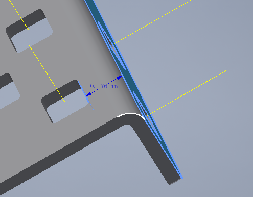

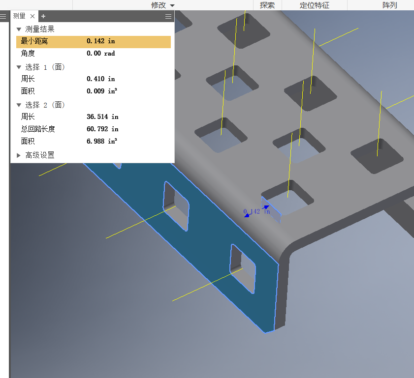

I don’t know why. After opening LIB, I found that some c-type aluminum alloys were deviated.
I want to fix him. But it seems very difficult.

I’ve heard about this issue from a few others this past season, I hadn’t run into any issues as a result of the asymmetry in my own CAD so I wasn’t aware of the problem until it was pointed out recently. I am not the original author of the library so I have no idea why this asymettry exists, but it is on my todo list to remedy this at some point in the near future. I’ll be sure to post on the forum somewhere when I get around to that.

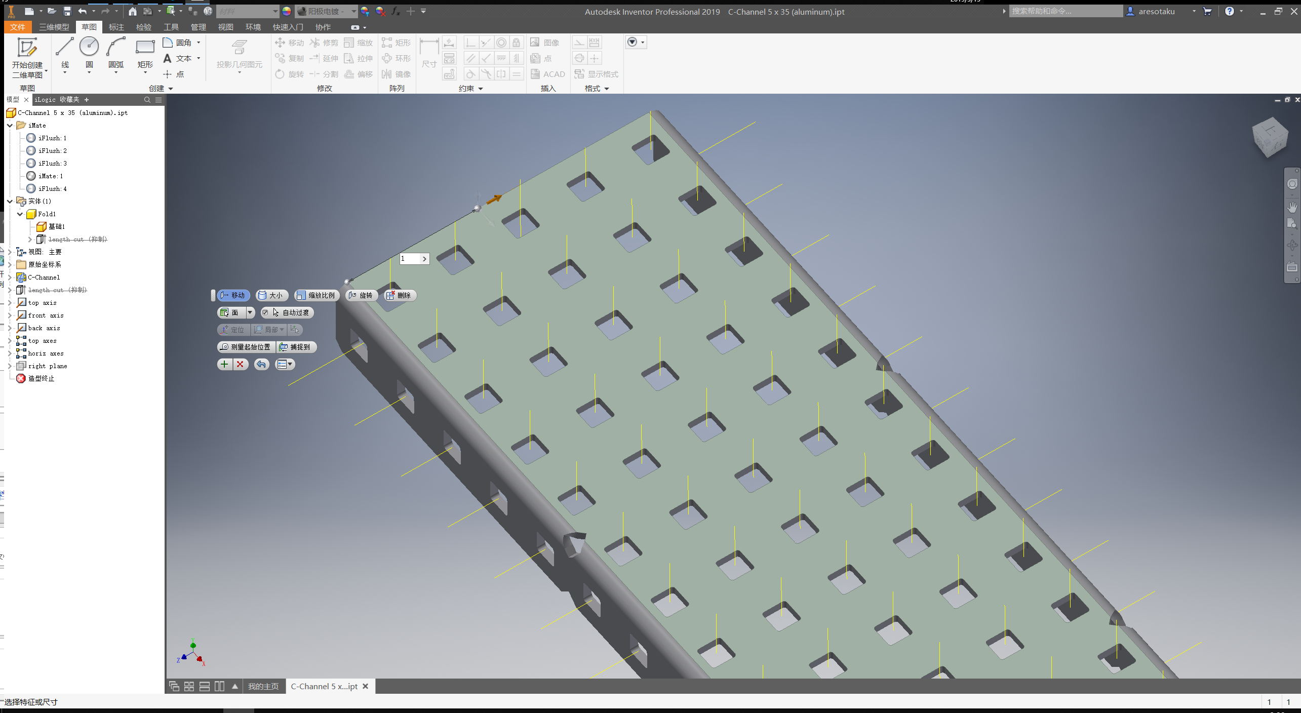

I’ve fixed him.
But there is still a problem.
If I use the iPart feature, the work axis will not display.
