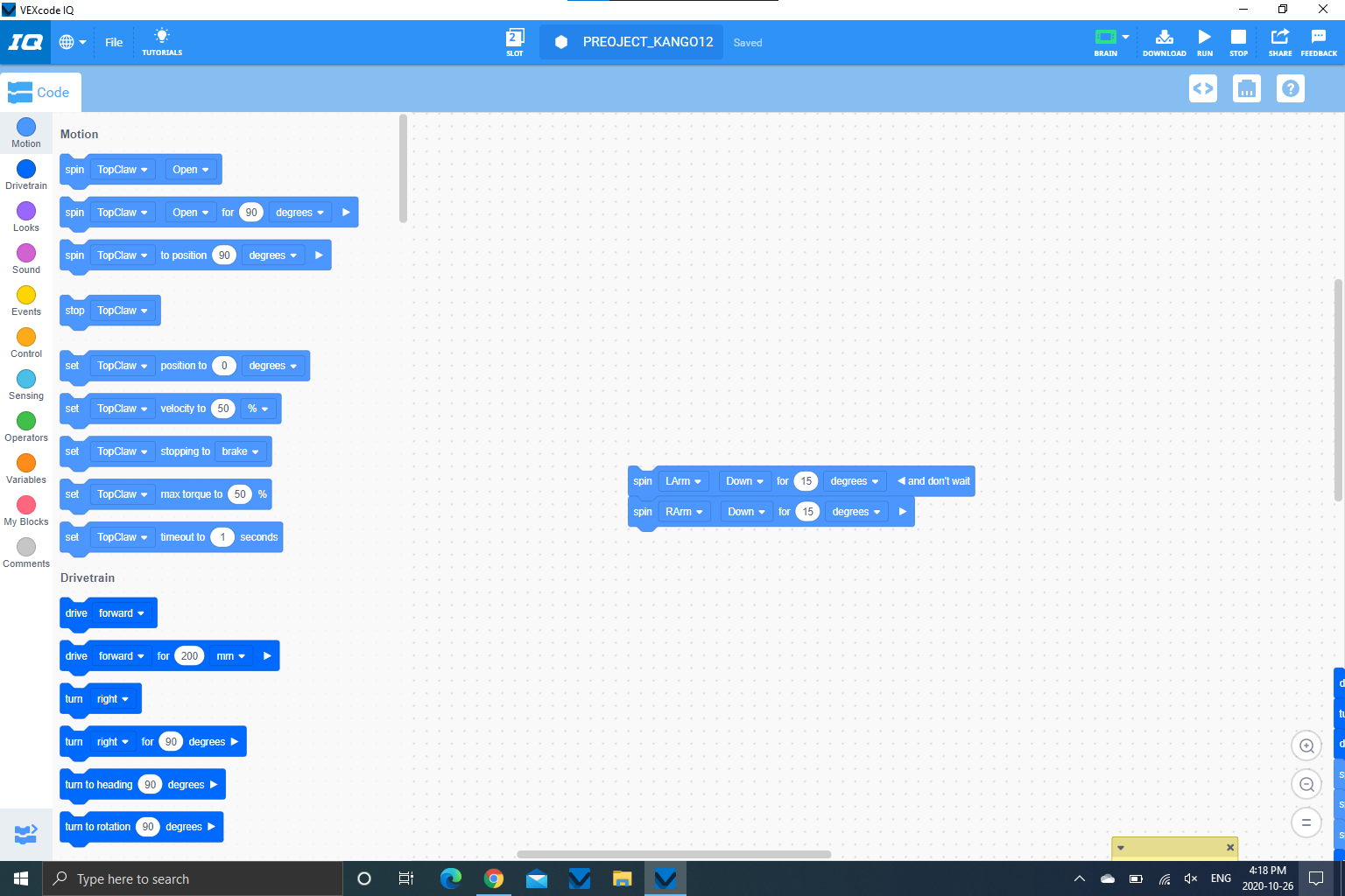

I’m trying to figure out how to get two motors running at once for our autonomous and my friends refuse to help me with programming so I’m at a lost.

We need some more context! What programming platform are you using (vexcode blocks or text, robot mesh, robotC)

It looks like you are using VEXCode IQ. My bad. Blocks or Text?
I’m using blocks because I’m a real noob at programming
You reverse one of the motors, and you click the arrow that says don’t wait. Here’s a picture:two motors running at the same time
