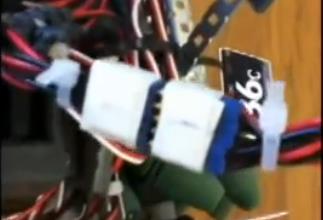

Making a disconnect is also useful because it allows you to take part of your robot off with only removing a single connection.

I’m interested in how you accomplished this. What did you use for the two ends of the disconnect?
Thanks.
I took all of the wires on one side, taped them together to make a square, and put a zip tie behind it. This was repeated on the other side also. To keep it together, a small amount of tape was used.
[ATTACH]8518[/ATTACH]
Ah, ok. From the look of the video, it almost looked like a modified battery plug. This might come in handy since our robot is going to get fairly tall when the lift is fully extended.

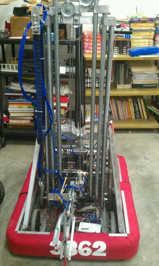

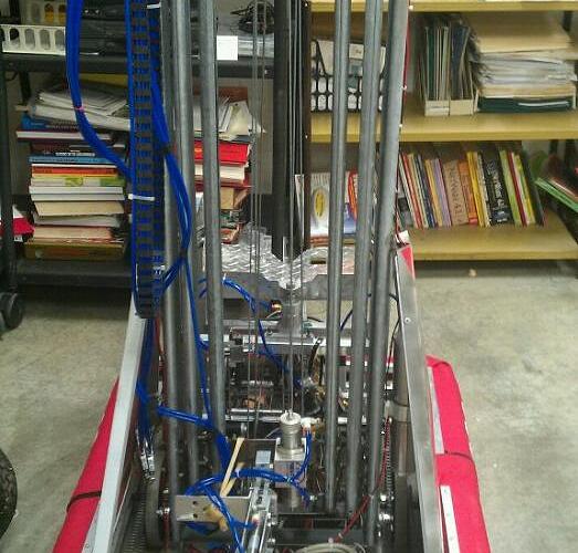

Even though we haven’t used it in VEX yet. Our team has had great success with using Igus cable track in FRC. Igus also likes to help out robot teams so you might be able to get a good deal on some of the track. The attached photo shows how our team used it to manage our pneumatic tubing on a 15+ foot linear lift.
