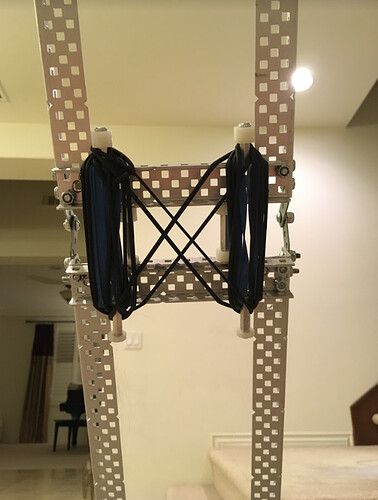

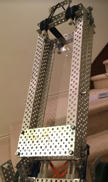

My team has a traybot with three trays. We can flip open the second one by lifting the arms/intake. If not, we could also intake cubes to open the second tray. However the third tray does not flip out with the second tray and we don’t know how to fix it. We’ve tried X rubber bands and horizontal ones, and both combined. We also tried having rubber bands on the side to pull the third tray downwards so it can open. Any other ways you guys open your trays or suggestions since ours isn’t working! Thanks!

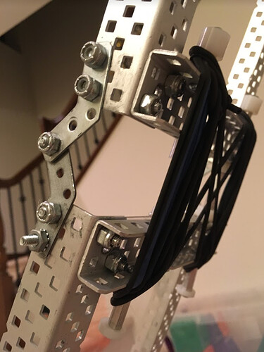

put rubber bands on it, and the momentum from your first flipout should trigger the second. otherwise you’re either banding wrong, or you have friction in your flipout joint.

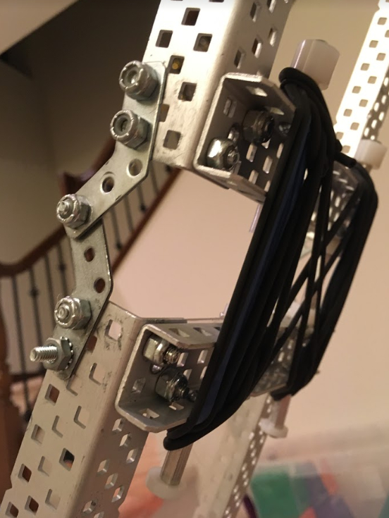

Make sure that the rubber bands aren’t further down than your pivot. they should be above it so it allows it to flip out ALOT better

so you know the point where the tray segments fold in. thats the pivot
like a hinge sort of

your joints probably have a lot of friction, or the third stage kind of sticks inside the second. pictures would probably help.
Just don’t put then underneath the pivot itself. that forces it down not out. like a rainbow keep it up from the pivot
how would I fix the friction? image
did you just change it or is this before?
This is how it has always been (might have changed rubber band type and placement a couple times but this is how it is at the moment)
when you fold it, do the rubber bands go beneath the pivot
