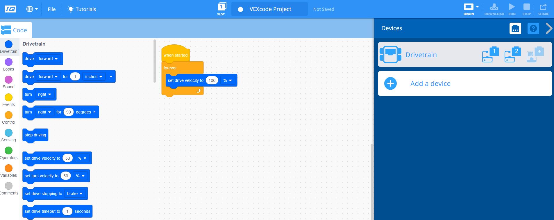

Hi everyone, I like to increase the speed of drivetrain in my robot. I’m not sure how I can do that. Should I add two more motors to drivetrain? Will that increase the speed? Or is there any way to change the default speed of motors? Or something else? Please advise. Many thanks in advance.

I think even in driver, the motors default to 50% speed. So you have to put in your driver control program the block “set drivetrain velocity” and set it to 100%. If you want to go even faster, you will need to do that mechanically… big gears driving little gears.
Got it. Thanks. I think this is what I need. How can I put the program in my driver control? I know how to use VEX Iq blocks software but I don’t know where to start to program the controller.
I’m by no means a programming expert, but I think it would look something like this…
drive velocity
