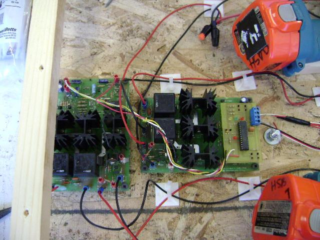

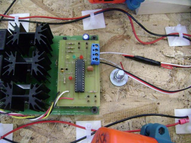

Looking at the Pictures, and a little Google Search with “electronic services” “motor controller” pic, got me this page as the first item, Diverse Electronic Services.
It looks like the MC-7 with a PIC Daughter Board…
I think I am going to add a note about “SHARP AND CLEAR” Digital Photos are the best…
attached with a RCIC2_SC microprocessor
Excellent. Based on that link, it looks like you would do the following:
[LIST]
*]Red: Leave unconnected. Normally this is used to power the receiver, but the Vex Microcontroller has its own power source.
*]Black: Connect to the outer pin of motor port #1 (outer pin means the one furthest from the keying tab on the port socket)
*]Yellow: Connect to the inner pin of motor port #1 (inner pin means the one closest to the keying tab on the port socket)
*]White: Connect to the inner pin of motor port #2.
[/LIST]
You will need a pair of Male-to-male servo extenders, or three of those M-M SparkFun jumpers I linked to in my post above. Or you could cut a pair of standard servo extensions and wire the cut end directly into the screw terminals on the PC board.
If you are driving this just via remote, then you will want to set up the remote for tank drive (23 mode), though it will operate like arcade drive because it has a channel mixer built in (if I read the specs correctly). That means you’ll just use the right joystick to drive it. You may have to reverse either or both channel 1 and channel 2 on the remote, depending on the way your motors are setup.
If you are driving this from software, you will set the steering value on motor #1 and the speed setting on motor #2: Setting motor 1 to 0 will steer hard one way, 255 will steer hard the other way, and 127 should steer fairly straight. Setting motor port #2 to 0 will be full reverse, 127 will be dead stop, and 255 will be full forward. Numbers in between these extremes should provide a proportional amount of steering or speed.

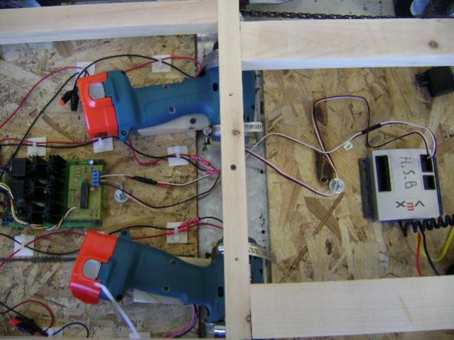

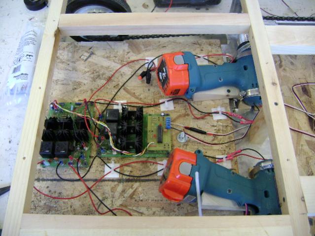

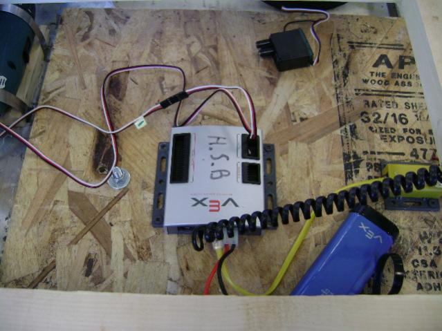

Connected everything the way you said but it doesn’t seem to be working. The circuit board has power but there is no signal coming from the VEX to the circuit board. Any ideas??? I have attached a picture of our set-up to help us figure it out.
It is hard to tell, but it looks like you’ve plugged your connector on motor port 1 backwards. White should go toward the keying tab/slot.
When diagnosing problems like this, the first step is to isolate the problem. First, I’d unplug the 2 cables and attach real Vex motors to ports 1 and 2. Then verify that they run as expected when the joystick is moved. This will clear everything from the joystick operator down to the Vex microcontroller. Second, I would try to hook the motor drive boards up to the R/C receiver just like you used to do and verify that works like it used to. That will clear the motor boards, motor wiring, and motor battery.
If all that works, then we just need to double-check the custom Vex-to-motorboard wiring (my analysis of the spec sheet, as well as the physical connections). If that checks out, then we have to figure out what the difference is between the signal coming from the R/C receiver and the signal coming from the Vex.
