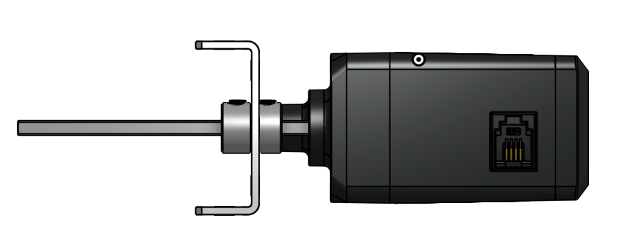

Hello, team 40994A here. I was just wondering what you guys would say to this question. What should we do in order to keep the inserts for the motors in on our drivetrain? We have been having this issue for awhile, and we might’ve found a solution, but I still want to see what you guys would say about it.

could you not just put a shaft collar or spacers that hold the insert in the motor between it and the C-channel
like this (sorry CAD model is a little scuffed)
So that the axle can go into the motor easily.
Due to the amount of pressure and speed from gear ratio, the insert itself comes out regardless of whether there is a shaft collar or not. We have began putting spacers on to try to solve the issue, but I want to check if anyone else has a different way of solving.
You only need one collar in your example, the one between the c-channel and the motor.
Ok thanks. We will try that.

@lacsap Yep noticed that after I made it the model still gets the point across I hope.

Indeed it does, I think it is a clear illustration of a typical assembly. Looking forward to future ones to share with our teams.

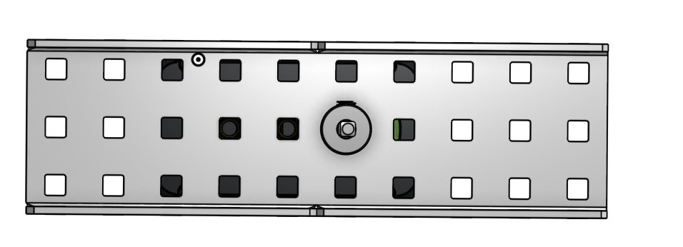

If you need any more help feel free to post a picture of the mechanism as this would help give us a better idea of where you could place a collar. :slight_smile:
make sure to use a berring flat so the collar is not contacting the metal.
A bearing flat is unnecessary as the motor supports the axle better than a bearing flat so a spacer should suffice.
A bearing flat is only needed on the other side of the drive train to support the other end of the axle.
I agree, just make sure there is a spacer to prevent the collar from rubbing on the metal.
We put a bearing flat on the side of the c channel without the motor. On the other side with the motor, we just kept the shaft collar close to the motor insert.

Do you mind if you tell me what CAD modeling software is this? I’ve been looking for the software, just haven’t been able to find it yet.
The website I use is called Onshape, it’s really nice because they have vex parts that you can download and port into your projects. There are also a lot of walk-through videos on YouTube I suggest watching first here. I am by no means an expert CADer so I suggest talking to people on this forum post if you want to learn more they know much more than I do. There is also a discord server dedicated to CADing ( I’m not in it I should probably join it) but here is the link. Hope this helps!
