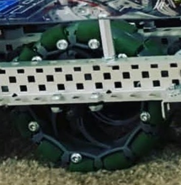

This type of brake will also not prevent you being pushed from the side (assuming you are using all omnis). To protect against that, you should either use locked omnis (see the attached photo- credit to team 240P) or a vertican brake that pushes into the floor (non-destructively of course). These are generally implemented with pneumatics, although it is possible with motors. If you use this type of brake, a PID brake will be mostly unnecessary.
