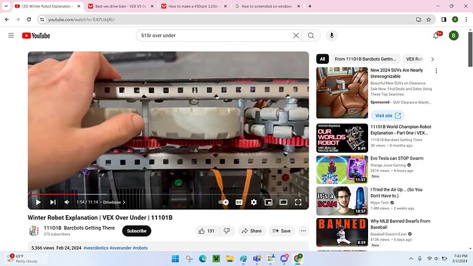

How to make a 450rpm 3.25in drive without thin spacers
I don’t know how to build a 450rpm drive. We don’t have 2.75in wheels. If anybody can tell me how to get thin spacers that would be great.
Ok… what do you mean by “thin spacers” (washers? 1/8 in?)? (Here are some vex ones and some robosource ones)
As for how to build it, that varies as every drivetrain-build is unique in its own way (hopefully). Here’s the first video in a tutorial series from spin up you can iterate off of:
Thin spacers like this.
I do not know where in the world you are, but in NA+ you can look for parts suppliers like Graingers or McMaster Carr. Probably could poke amazon hard enough to get a result as well.

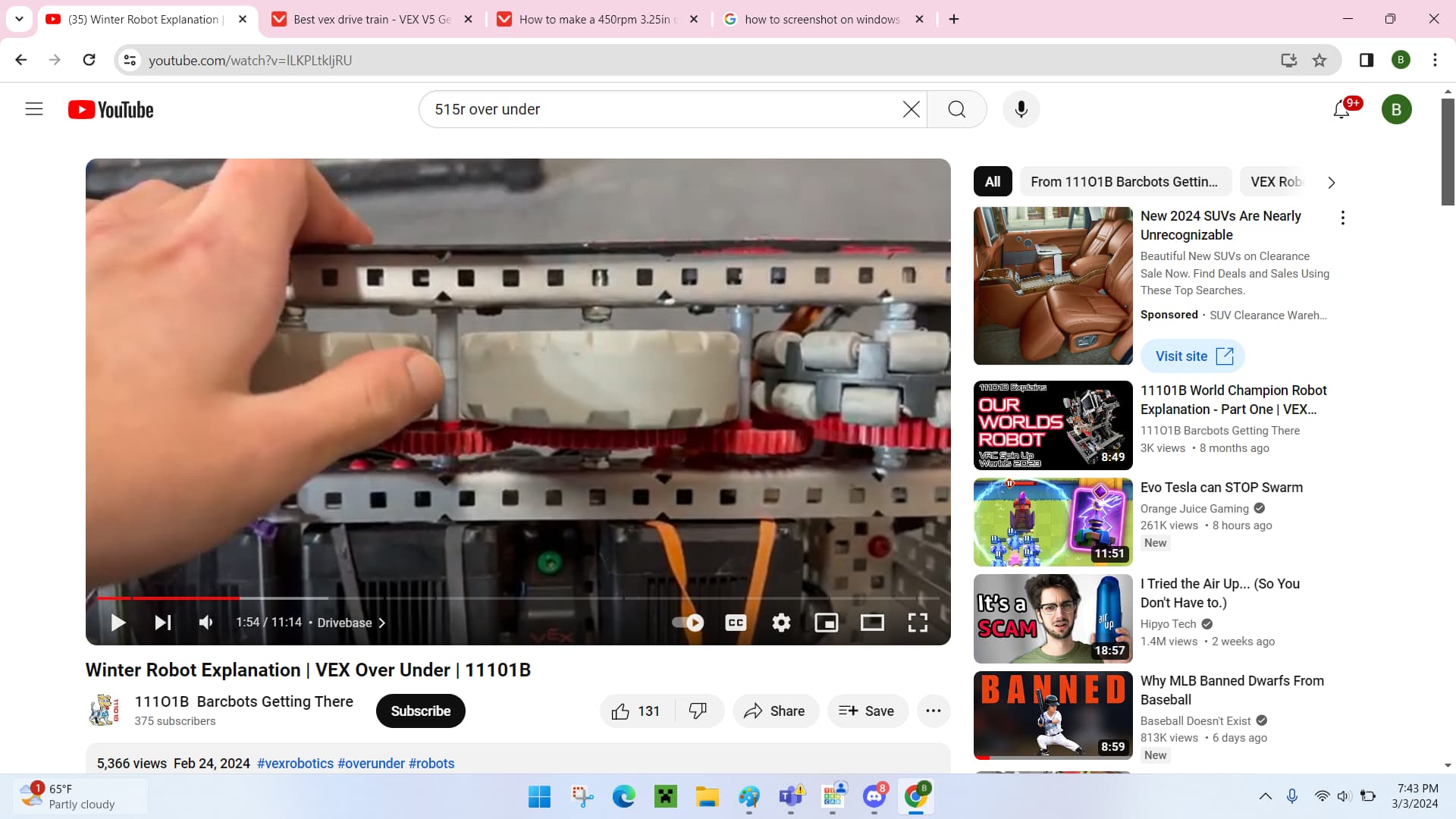

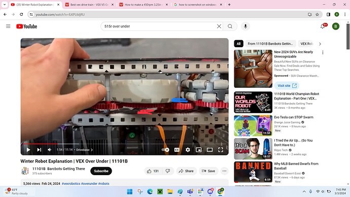

What we did was we added a spacer in between the wheel and the chassis frame (red). Then we added a shaft collar on the 36 tooth gear (blue).
