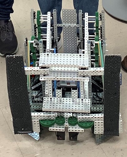

@enothecool, @7035 is attempting to make an expanding claw (like our bot) that folds out to reach a capacity of 5 cubes.
You mean like our robot?
yeet
kind of, but with extra lengths to the claw that fold out when the match starts.

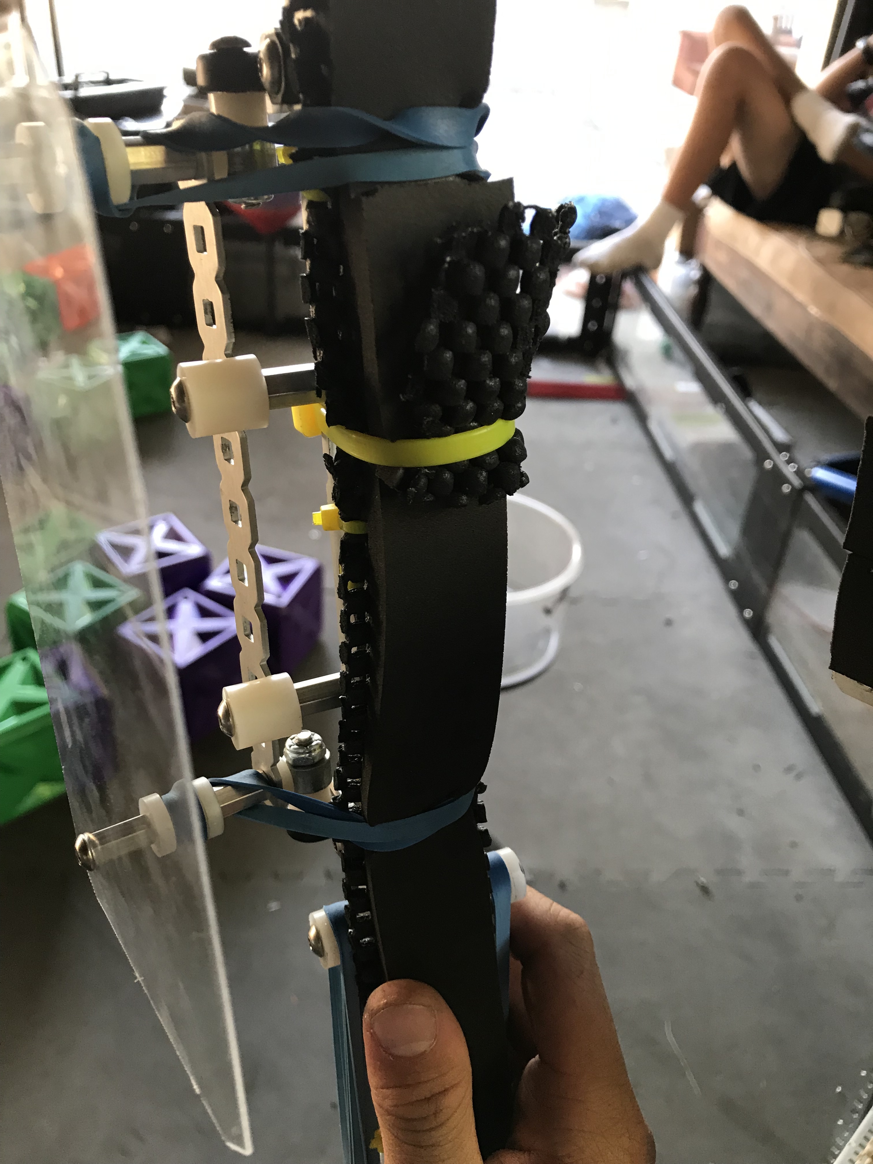

@7035, I believe this is what you are looking for:
IMG_0845
It uses screw joints for smooth movement. If you are still having issues, message me with some photos and I can try and help you out.

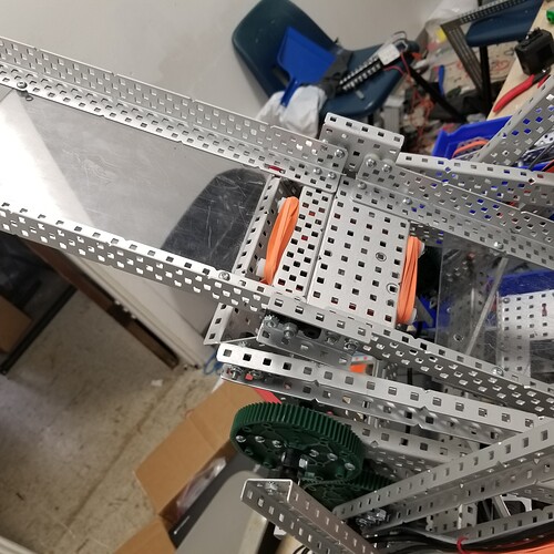

How do you get the two c-channels to align when the claw fully extends? And how do the polycarbonate pieces at the top of your robot fold out?
I’m trying to build something similar to your robot, but the claw folds out from the inside.

Ah I see what you mean, like the thunder Jeep
I’m part of thunder jeep lol

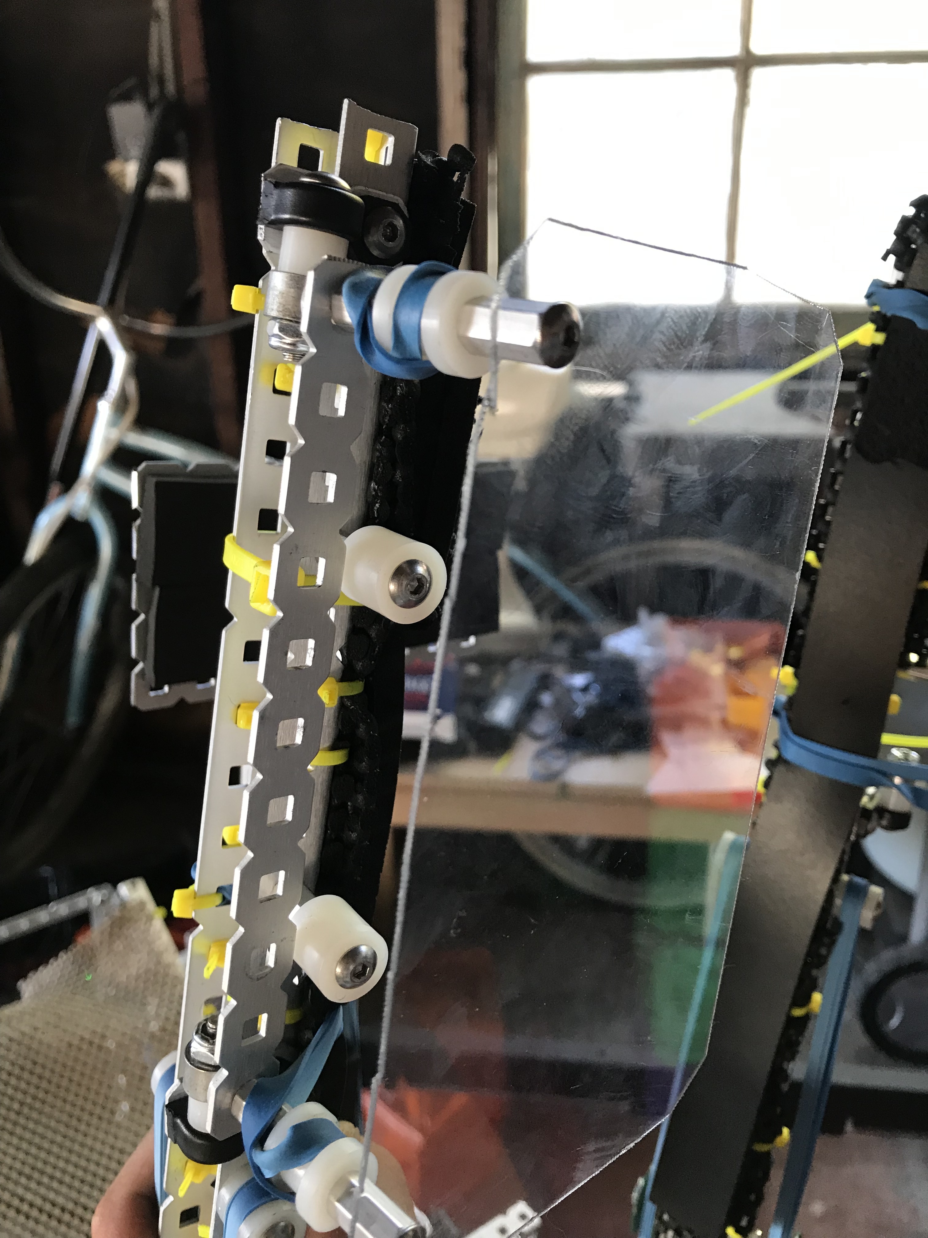

When we built our hinge, we were able to screw in like a 1-hole-long c channel that makes the whole thing flush when fully deployed as the top fold out hits that small piece. The same thing can also be achieved by making the channel one hole offset, saving the trouble of adding that small piece near such a crowded joint space. For the polycarbonate pieces, we used screw joints again to fold them like this:
image image
We are actually trying to build a better intake that folds from the inside out as well (better compression and no worries of them bending and the cubes falling out), let me know how it works out for you guys.
