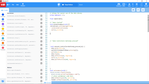

Hold code I made in blocks but I converted in C++. Hope this helps.
