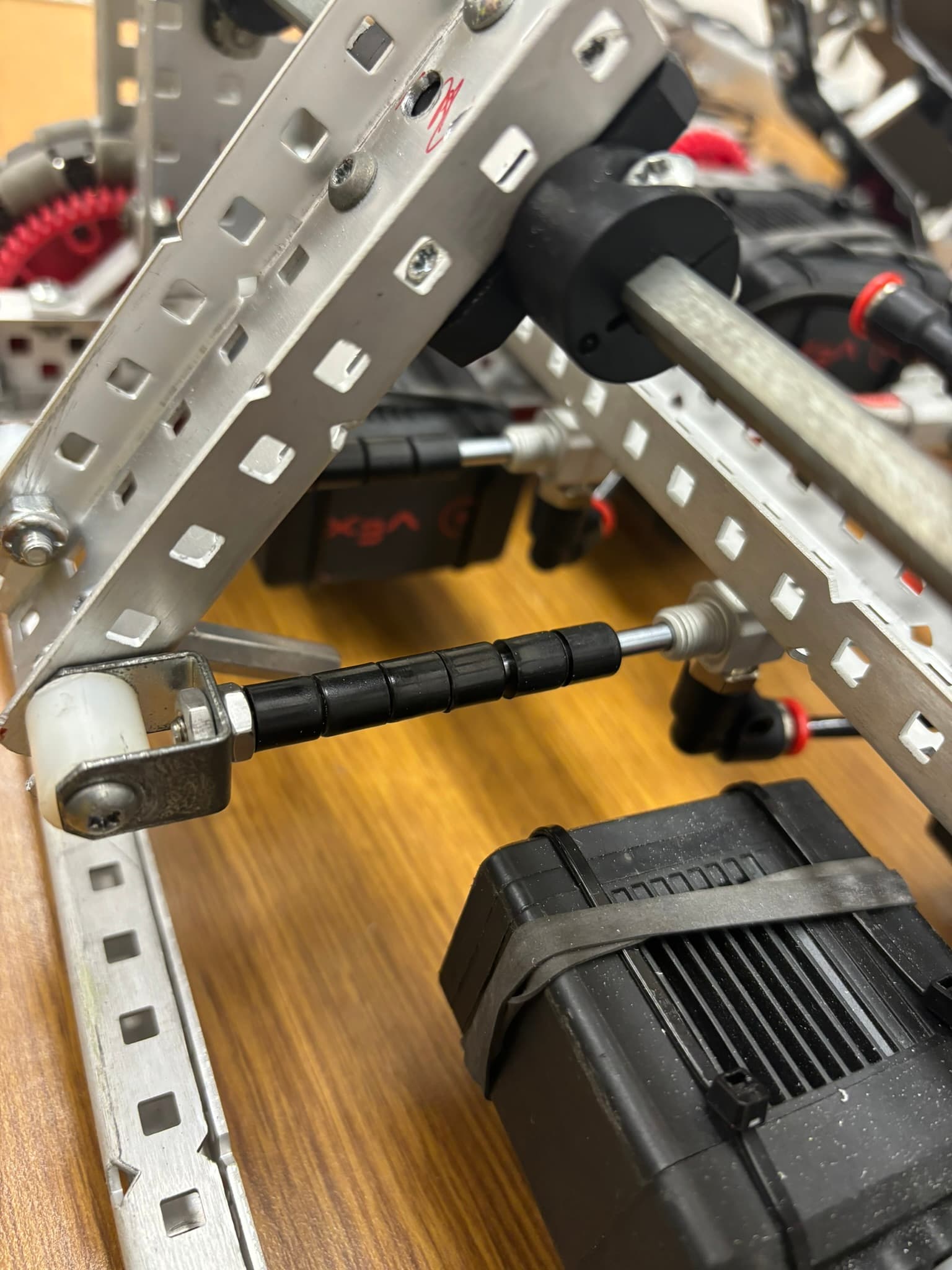

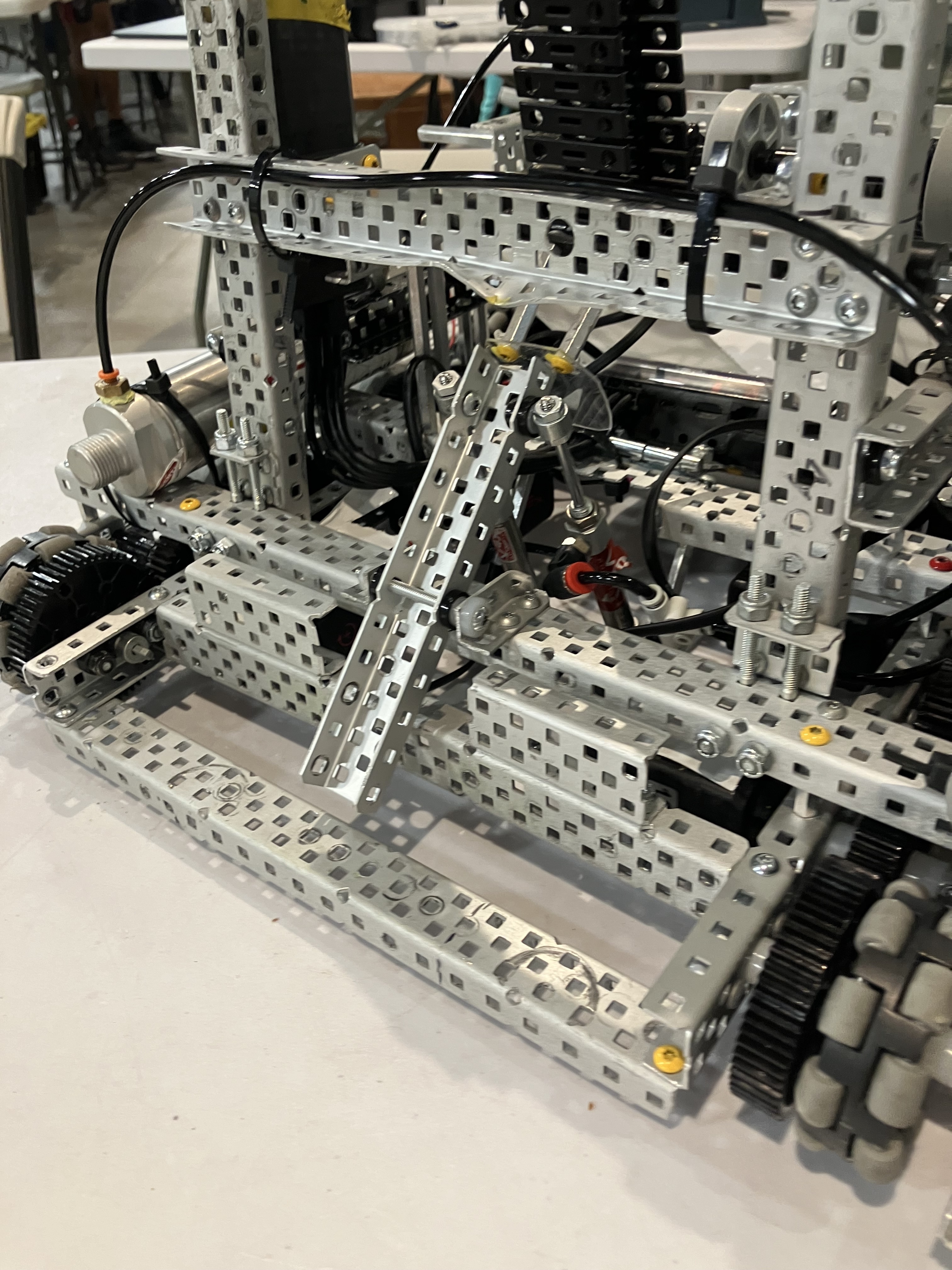

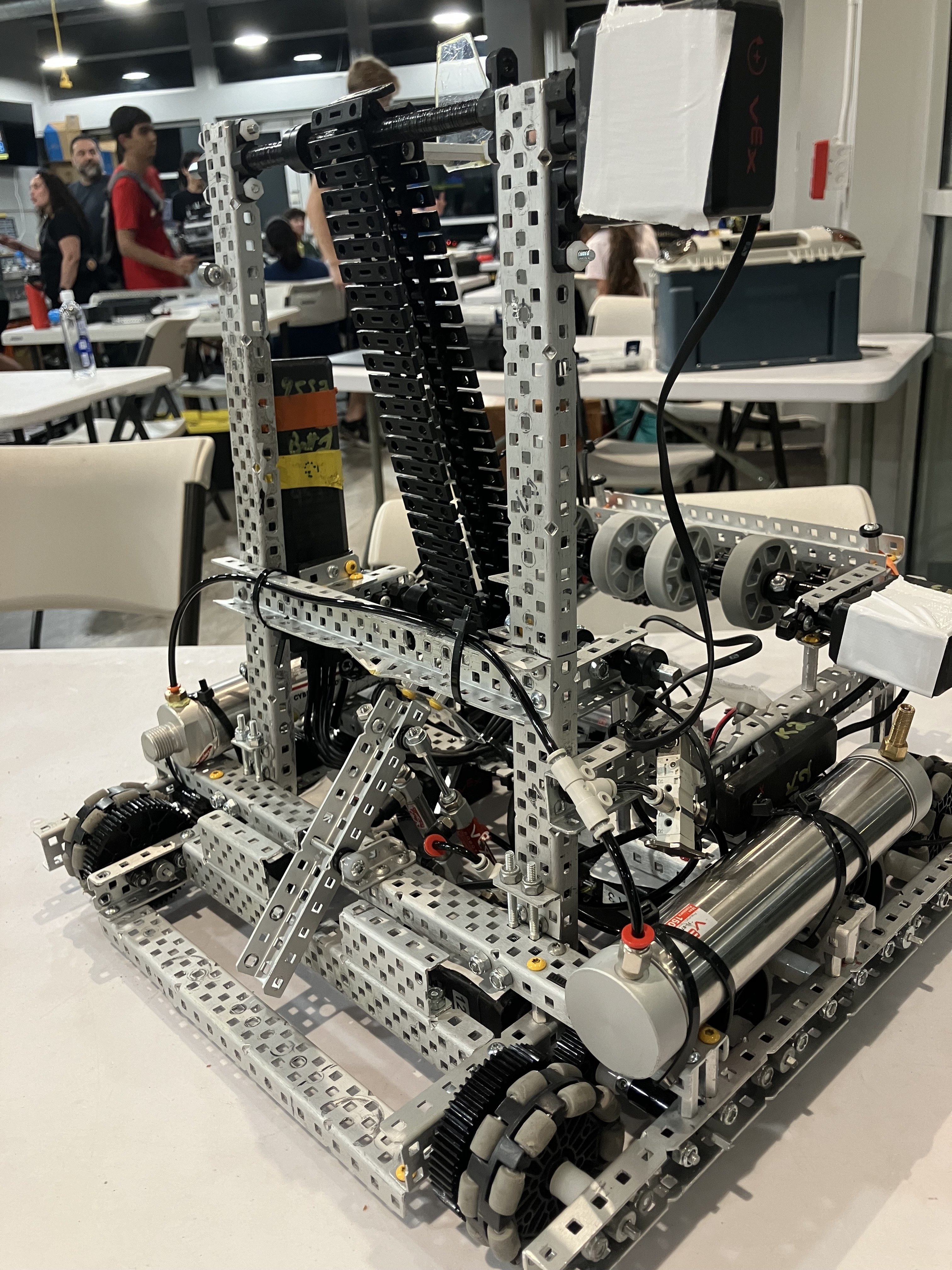

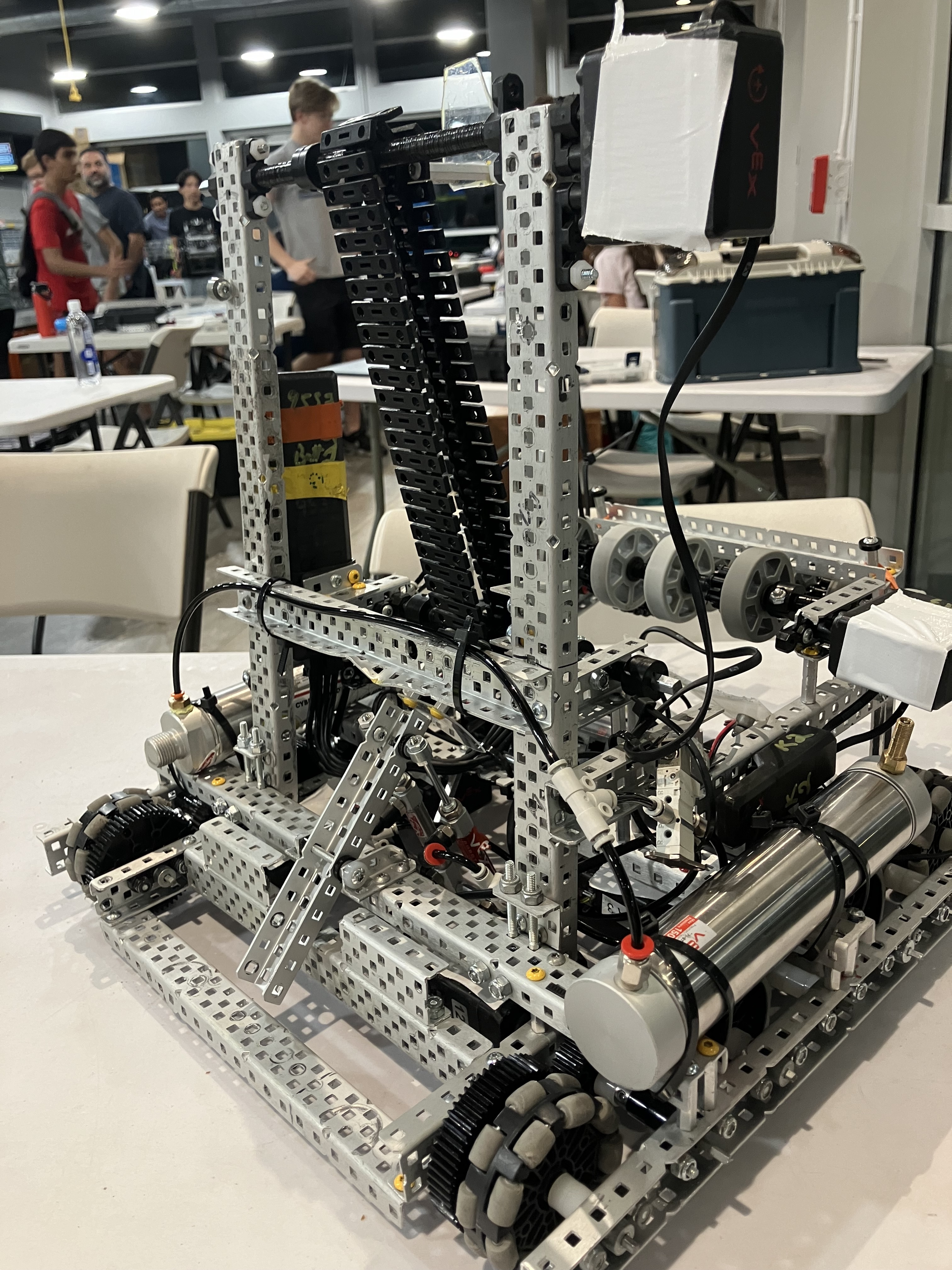

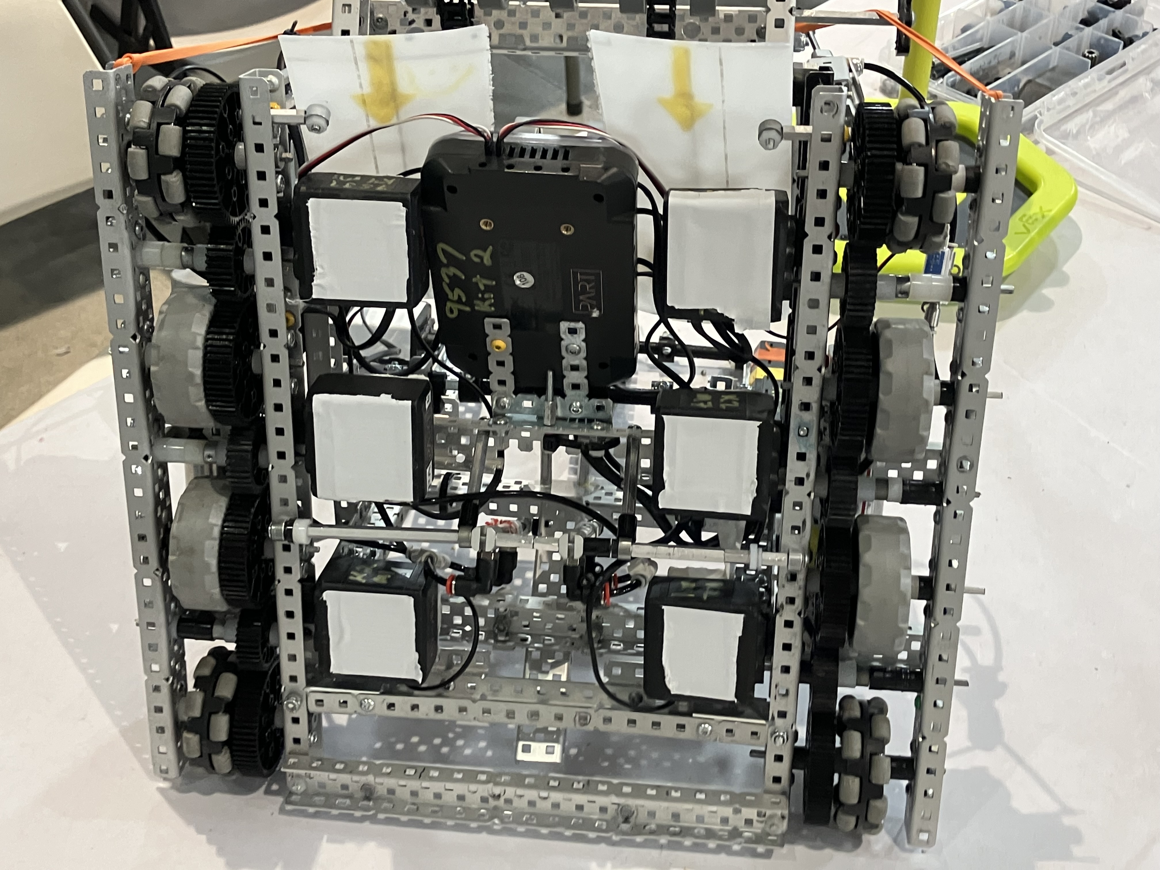

So we have a problem with our clamp, and it’s the at our pistons simply aren’t strong enough. There should be pictures included of our design. The other teams didn’t know either, and he have a competition very soon. Could anyone help us?
Increase the arm length, so there would be more power (type 1 lever). Also I suggest adding rubber bands to increase to retraction strength.
I dont think this will make it stronger but if you were to screw the shaft collar onto your piston and run a longer screw across the mogo to make a more secure connection. Really the only ways i could think of would be to add more pistons, make a longer lever arm for the effort side, and check for any leaks

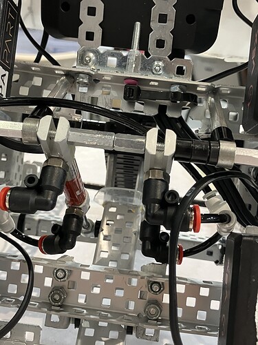

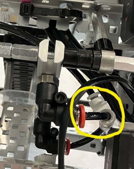

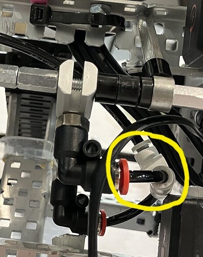

The issue is you aired up both ends of the piston together. Big no no, but understandable if you don’t fully understand pneumatics. I’m based off the images the pistons extend to clamp the goal and i’m assuming you’ve tested them to where they do extend out to clamp the goal. That would make sense because even if you apply air to both sides of the cylinder at the same time the extending side has more surface area on the piston meaning it has more force out powering the retracting side, but is still highly underpowered. You need to apply air to the bottom end of the piston only to extend the piston in turn clamping the goal, then you could have a separate air hose the goes to the top of the piston to retract it and unclamp the goal.

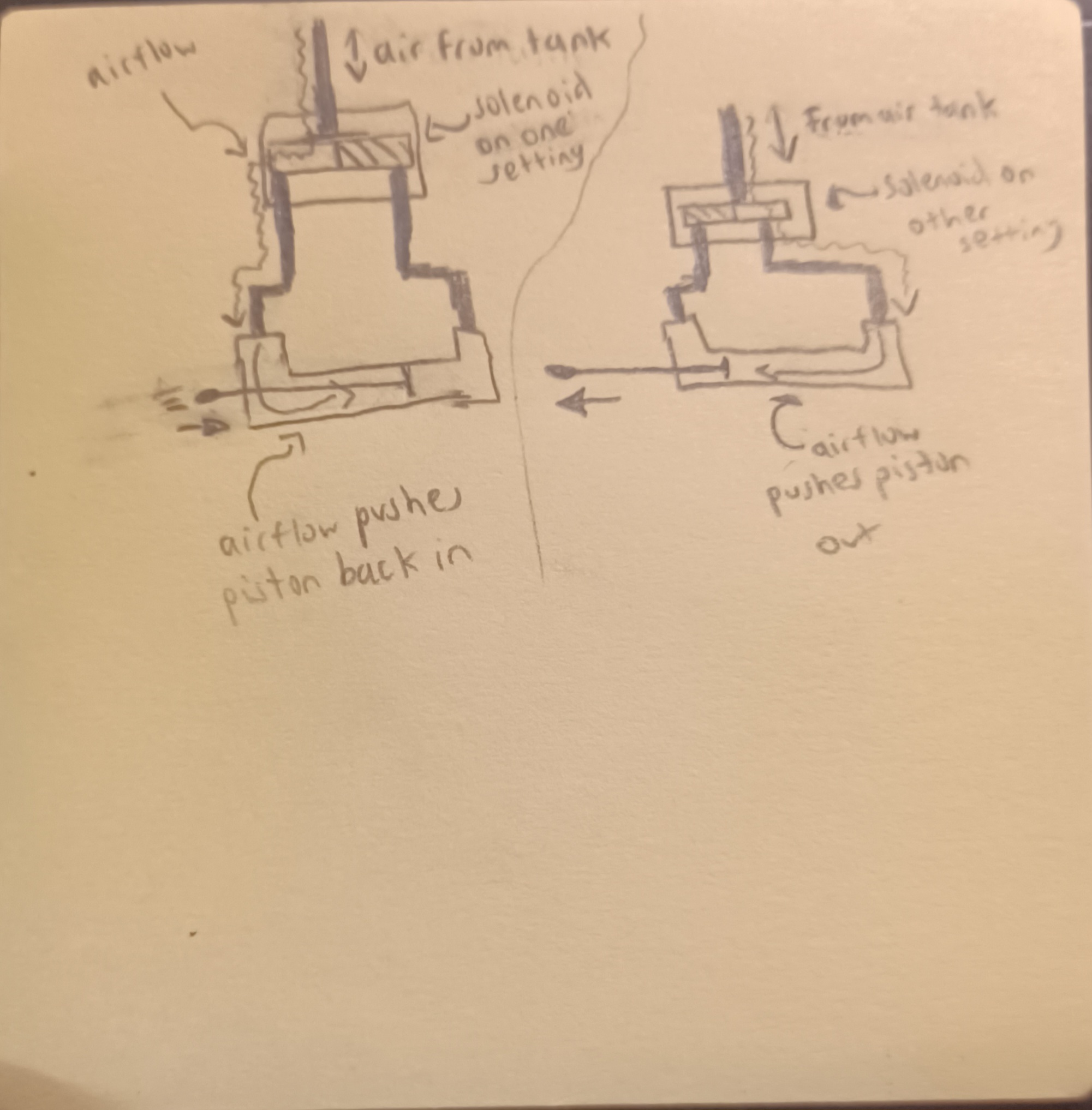

Yeah @9537zFodder that probably means you haven’t read this article:
Here’s also a jank, really “rough” basic diagram of how pneumatics works:

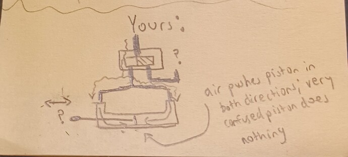

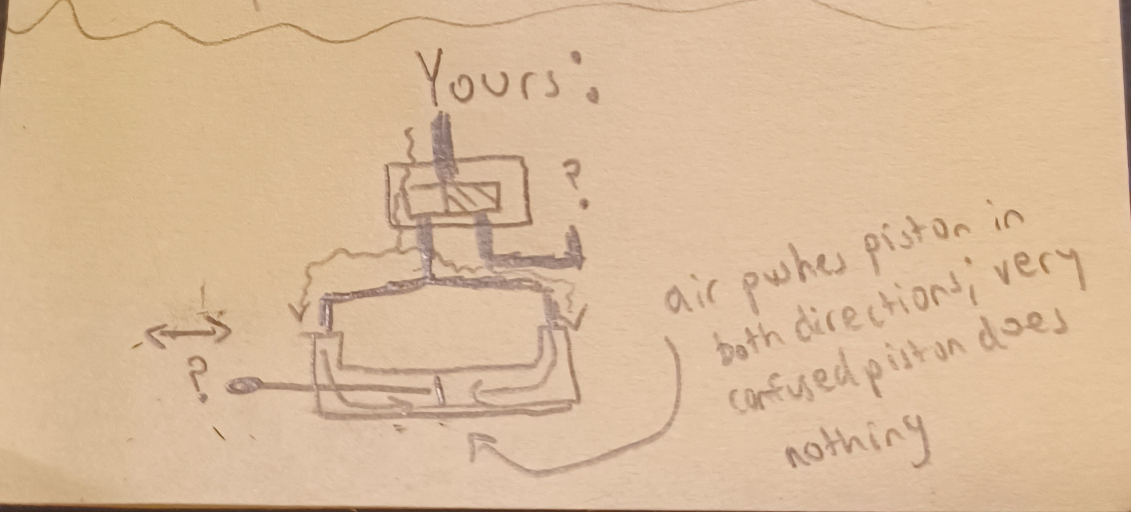

Right now, here’s what yours is doing:

“confused piston does nothing”

Well, he connected both ends of the cylinder together. That’s a big no-no.
Thanks for this, but does that mean we should remove one of the pistons? I’m personally fine with doing that but would prefer not to if there is a solution.

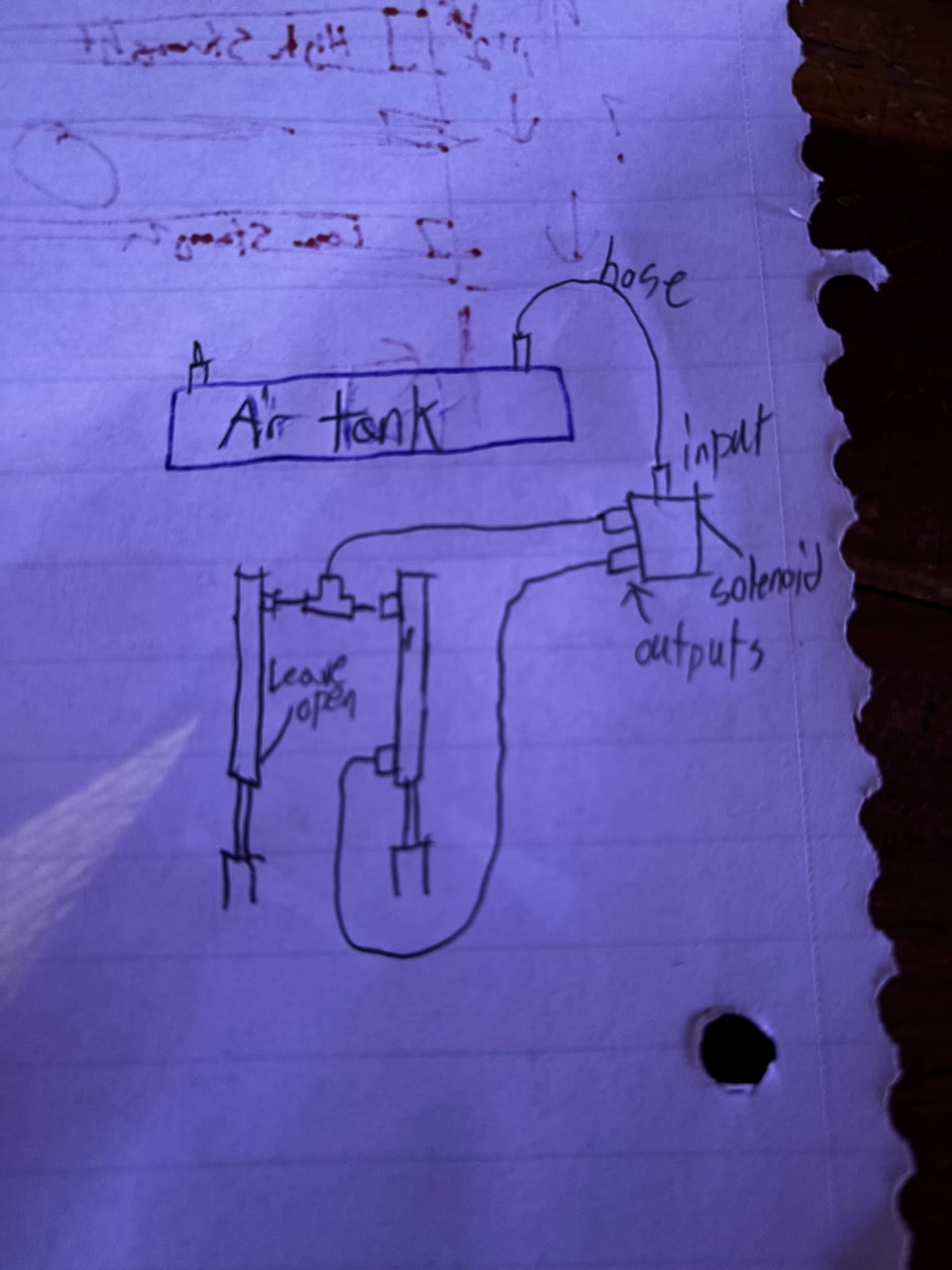

No what I meant was keep the two pistons, and air them up to clamp the goal, but you only technically need to air one of the two pistons up to release the goal.

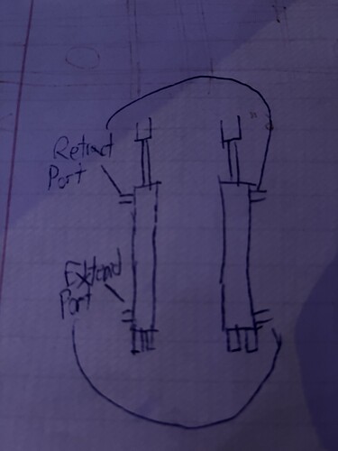

This first image is just an image explaining what i’ve meant by extend and retract ports.
This second image is an example of what your setup should look like. The extend ports are aired together using a t-fitting and then go into one of the outputs on the solenoid, then the retract port of one cylinder is left open without a fitting, then the other retract port is aired straight into the second output on the solenoid. This setup allows for you to use the power of the two pistons for clamping but only use one pistons worth of air to unclamp the goal. Hope this makes sense :slight_smile:

good line, but theoretically not accurate. The ‘blind’ side of the piston (the side opposite of the rod) will have a larger surface area for the compressed air to act upon than the rod side area (which would be the area of the piston MINUS the area of the rod).
Therefore the piston should extend but will not be with as much force as it would if plumbed correctly.
Think of the piston force extending normally. It would be calculated by the area of the piston times the air pressure. To retract, it is the area of the piston minus the area of the rod then multiplied by the air pressure. The retract force is always smaller than the extend force. In this case there is still a delta extending force and the rod should move out.
