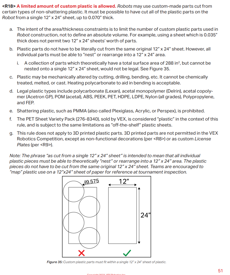

Hi, and welcome to the forum! To answer your question about 3D printing in VRC, please refer to the game manual, which I have linked here: VRC Over Under Game Manual - VEX Robotics , and look at rule number R18, number 7.

Hi, welcome to the vex forum! In VRC you can only 3d-print parts that are non-functional / decorational. So to make wings usually people use polycarbonate, and there is also a maximum thickness that you can use for polycarbonate which is 0.07" thick:

It specifies in the game manual under robot rules. Rule r18,19, and 20. You can purchase the material form robosource or straight from vex but it might be a little bit more expensive.

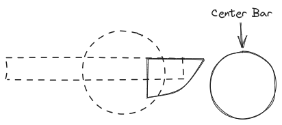

  1. Grab a 12x24 sheet of 1/16in polycarbonate from RoboSource.
  2. Cut out a shape roughly like this:
  3. Mount it to the front edge of your drive, drilling screw holes where necessary:

Thank you, this is a very good sled idea, we will use this in our robot chassis.
