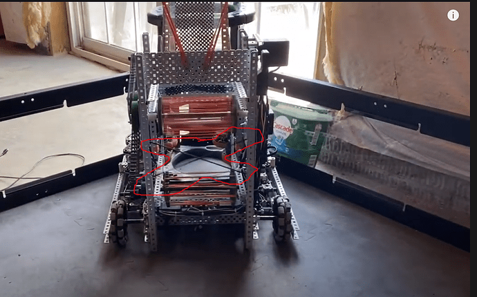

So, I had a fully functional snailbot yesterday. It had a 1200 RPM elevator and a 600 RPM flywheel. It had a sweet X-drive, flip out arms, and a hood that used Zip-Ties as a pivot (I have no parts). But I wanted more. I wanted to build a pooper. So I came up with a design very similar to 97963A. 97963A Early Season Reveal || Vex Change Up - YouTube
I am absolutely confused on how the pooper is able to overcome the rubberbands. Should I be increasing torque? Or is there something about that design I am completely overlooking?

the way I do my pooper is that I have the largest rollers I can so that there is a large range of compression for the ball, so it can squeeze through the back if I poop, but it never accidentally poops. as far a it stalling, I run my top pooper roller at 200 rpm and the bottom roller at 600 rpm. so they can be pretty fast without stalling if you have the proper geometry and build quality.
So ofc this isn’t my robot, but its those rubberbands in the back. Also I think I understand what Xenon means, ofc he has a great pooper. So Xenon, is the rubber band in the back of your robot just for hoarding?
well that’s not my robot either lol.
I have a one ball hoarder using a rubber band yes, but that’s 97963a’s bot. I think the purpose of those elastics are to stop the balls from accidentally pooping, but I’m not sure, I never had that issue.
I think they are using the rubber bands to increase compression. They don’t have a hoarder yet.
I completely agree :grinning: :wink: :innocent:
Tbh, if you’re having problems with accidentally pooping, you might want to consider removing the bottom roller altogether. Running only the top roller somehwere between 300-600 rpm will give you a similar/the same pooping speed as 2 rollers.
the reason I have a bottom roller instead of just a ramp was to give more of a range of compression. with only one roller, there would only be like 1.5" of compression before the ball hits the axle, but with 2 I can get like 3" of compression. this lets me need less torque when pooping, but still stops anything from accidentally slipping out. one roller could definitely work though, I just tried 2 from the start and it worked great so I didn’t feel any need to test one roller.
If I’m correct, 97963A has a little bit of tubing on the back to provide a slight amount of tension when the ball is stationary between the rollers.
