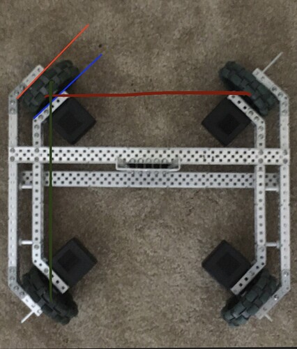

IMG-8276
So that’s it in all its beauty, of course now theres a lot more on it
Are you testing this on carpet?
Nope, Its on the vex foam tiles now
The design seems alright, but I would square up some of it.

The problem is your wheels are not the same distance apart. In addition to that, as Cody said, vex parts are not perfect. Use Robosource shoulder screws when they come out and lexan gussets and you can reach really low slop.

Ethan brings up a good point, are you using spacers of the exact same size on all the wheels? Ideally you’d partially use the shaft itself as a standoff as sorts by making it the exactly (or close to exactly) the correct length.
The reason isn’t the spacing on the axle, it’s just that vex gussets don’t create a rational horizontal distance. He is constraining his x drive with his supporting c channels which have a rational horizontal distance between holes; each hole is in 0.5” increments. So because of that, if he tried to connect the remaining gussets and add a c channel across, it wouldn’t fit unless he forces it or drills holes somewhere
Ah yes, I forgot about that. I always start in CAD and the wheels get positioned first. Humm.
Yeah I see it in the picture now. Ooph.
It’s best seen in cad but I don’t have my computer with me rn. But it’s one of the reason why people make custom lexan gussets to compensate for this (the other main reason is that it gives more contact points and places to screw things in)

Never underestimate the value of a long level. You can use it as a straight edge, but if you flip the robot on the side you can see very small quantities of drift.
And while I agree with Cody on CAD first,but because of the square holes / round screws there is a chance for build slop lots of build slop, trust me, I’ve had lots of cases of “Cody Design Fails” that are because of builder ineptness.
@RandamRobotics you are close, get a small square and check the angles.

The red and green lines which represent the horizontal and vertical distances between the wheels (not to scale) aren’t equal. The vertical distance is irrational because of the way the vex gussets are made and the horizontal distance is rational because it’s constrained by the c channel
