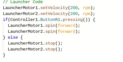

Depends. What is hooked up to ports 2 and 3? If its a motor (which I assume it is), then you can just do a general if()
statement just making both motors spin. For example: my flywheel is 2 motors, run by one button:
So to answer your question, just put what you want to do for both ports under an if statement for the one button.
Hope this helps!
