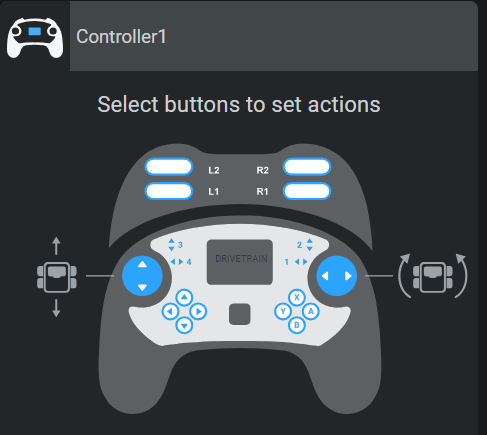

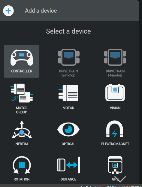

If it is a four motor or two motor (e.g. you have set the drivetrain as a device), you can follow these steps:
  1. Add the Controller
  2. Click the controller stick three times till you see this:
    The right stick is to turn and the left stick moves forward/backwards
