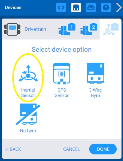

My team (me) had just decided to switch our programming with text based code and have decided the incorporation of the inertial sensor into the build. I’ve done some research online, through vex forums and on youtube but was overwhelmed with new terminologies that I don’t know about. I’m rather new to programming but have done some basic programming corses and our team is as well to VEX generally.
Are there any good advice to the programming of the inertial sensor (to drive and turn straight)? Or just general advice to start working with VEXcode Pro V5? Any response is welcomed! :slight_smile:

I do want to share that there is a shortcut for the inertial sensor. The Drivetrain does allow you to add an inertial sensor by default. This will greatly improve the accuracy of your robot auton movement.
It does a pretty good job but it’s not as accurate as some of the advanced code you will find on this forum.
If you are just starting out then this might be a good place to learn. Later if you want the high speed and incredibly accurate robot movements like you see at Worlds, then you will need to spend more time learning to get the full potential out of the sensor.
