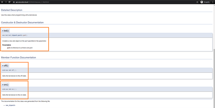

The website linked gives you the resources necessary. You declare an led object and call its on() and off() methods to control it.

led_docs

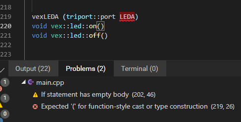

Hey Mr. Sazrocks, so today I tried programming the LED lights and it seems like this code is innacurate because it does not clearly or accurately what paramaters to set up.

Can you share your code? What does the light do?
Sure I am just getting alot of errors I am just trying to make the led lights stay on the whole time. GIve me one second to send the code.
Make sure to post the error messages as well as the code.
Don’t worry about the first error

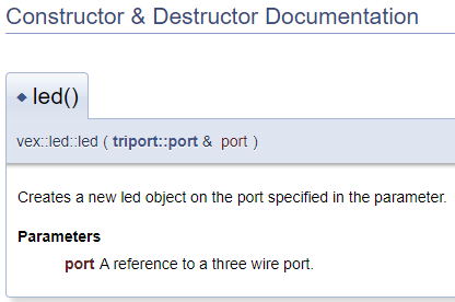

The documentation page was generated from the code itself. It is by definition accurate. It is as accurate as it could possibly be.
There is a single parameter which must be passed to the constructor, and that is the port that the LED is plugged into. This is very clearly and accurately stated:
LED_constructor
Please show us your code.
That’s not at all how you’re supposed to do that…
Sorry wrong screenshot
You don’t seem to know C++ very well. I suggest that you learn the basics of C++ through some tutorials or other curriculum before you continue here.
